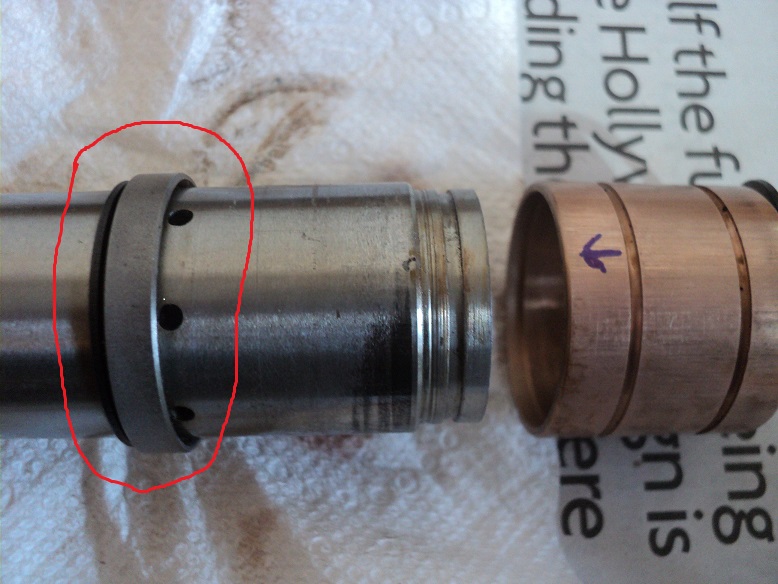

Does this ring come off? It does not want to move.
forks 003.JPG (155.63 KiB) Viewed 2976 times
Posts: 5681
Post by G-Man » Thu Mar 12, 2015 3:47 pm
Yes - its supposed to be free as it provides the bump - rebound damping function as a valve over those holes.
