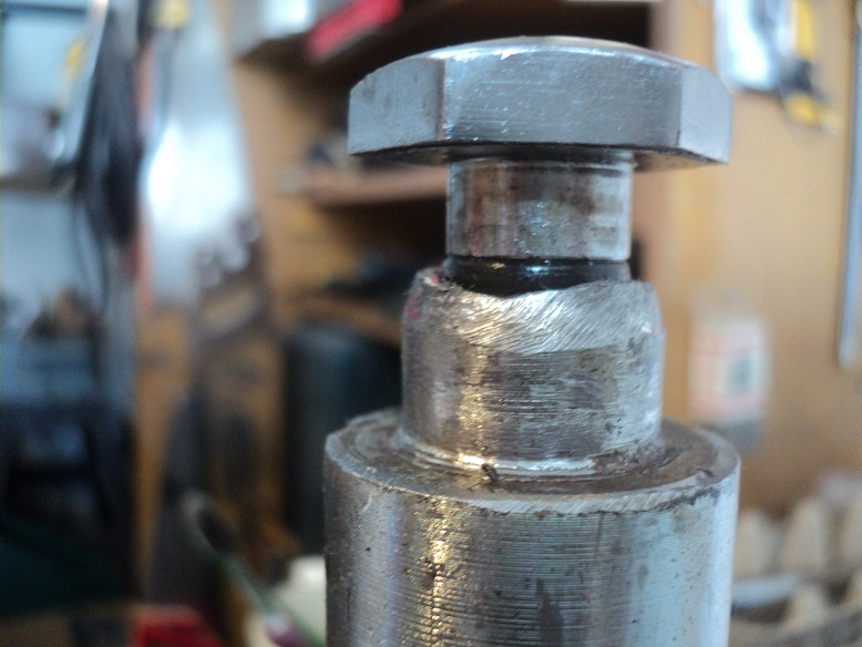

Here is what I discovered someone had done to the top of one fork tube.
Why is it that some people think they instantly become motorcycle mechanics the day they purchase a used bike?
I will be looking for some Type 1 forks on E-Bay. Hopefully I can assemble 2 good forks from 4.

G-man cautioned me about early "fatter" forks. The ones I need to replace are 33mm where they slide in the seals, and 32mm above the taper.
I was hoping that I would be able to build 2 good forks out of 4, but perhaps yours are in better condition.
