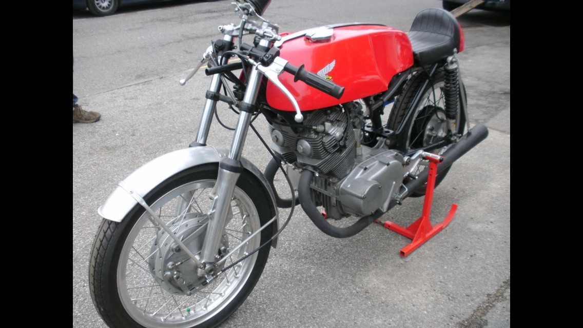

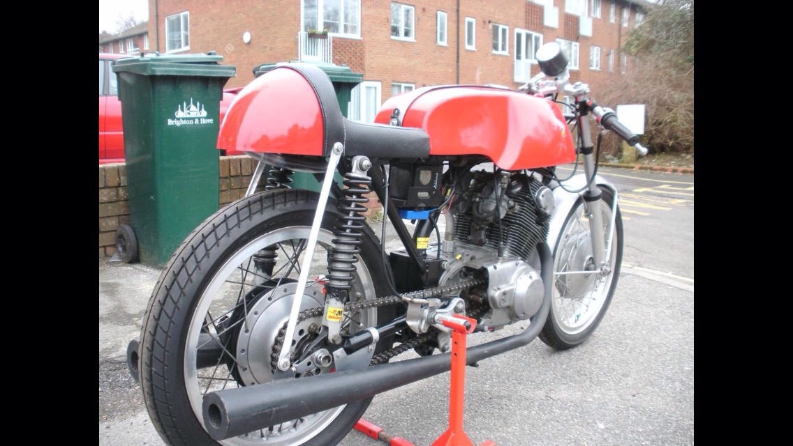

Some pictures posted. Fairing on (just, not quite right but it's the one it came with). Next it stop the leak and then look at megacycle cam/nova 5 speed box and a bit of head work.
