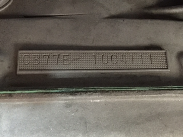

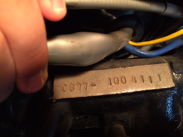

I remembered to take the pictures last night. Hope i am doing this correctly.
Engine Number
Engine Number
Engine #.JPG (92 KiB) Viewed 3224 times
Frame Number
Frame Number
Frame #.JPG (83.33 KiB) Viewed 3224 times

Post by LOUD MOUSE » Tue Mar 17, 2015 9:31 am
Good on ya.
Great pics.
The engine is no doubt HONDA however I suspect the frame is a replacement.
Why.
Well HONDA painted all frames then stamped the numbers through the paint.
From what I see there is bare metal at the number location. (no sign of paint around the numbers which don't show any sanding after they were stamped.
Not saying I can't be wrong on this but that is what I see..................................lm

Post by jensey » Tue Mar 17, 2015 3:08 pm
I agree, replaced frame.

Post by djbrown » Wed Mar 18, 2015 1:10 am
LOUD MOUSE wrote:Good on ya.
Great pics.
Why.
LM - Bummer, I hope you're not right about the frame but here's what I see on my CB77.
- Left side of the head tube - You are correct, the frame is bare metal where the frame number is stamped. There is no residual black paint, not even down in the numbers.
- Right side of head tube - Matching flat area on the right side of the head-tube is painted but has no numbers.
- My CB77 did not come with a title just the sales receipt for my sale and the receipt from the previous sale. The gentleman I purchased from had the bike only a few months.He purchased the bike from a guy in Boulevard, CA (east of San Diego on the border with Mexico). I think he said the guy was a pig farmer, Vietnam Vet and an HD collector. The Vietnam Vet and his father had restored the bike back in 1985 with the intention that his father would ride it. Right around the time they were completing the project the father had a heart attack, he survived but decided it was best not to ride motorcycles anymore, so the bike sat in his garage until he passed away in 2003. The son then retrieved the bike and brought it to his own garage where it sat until Late 2012 when he sold it. I heard the Vietnam Vet and his father had purchased the bike from someone in Nevada and that is as far as I can go back.
How can I determine if my frame is an authentic Honda or not? I searched for reproduction CB77 frames and did not find anything. Any help would be appreciated.
