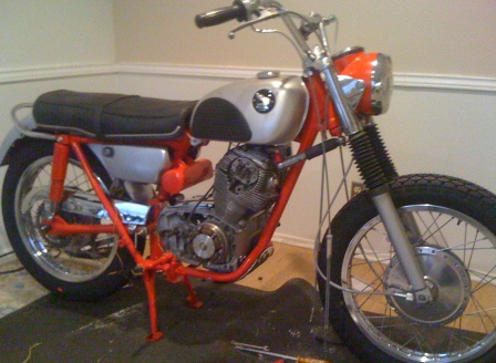

By the way, I am including a pic on the progress of my CL77.

Post by davomoto » Thu Oct 13, 2011 10:02 am
Looking good! I love these bikes in red. I'm going to do my 65 CL77 in red.
