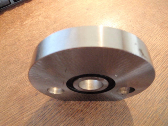

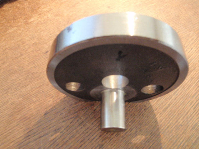

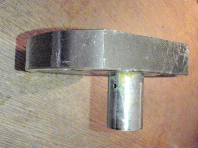

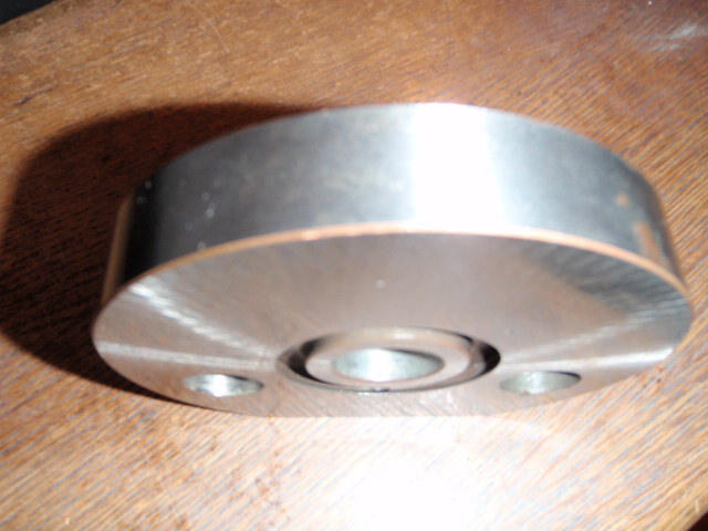

Hi,
Checked a NOS right inner crank half and LM is right, there is no hole in the big end pin where it meets the right crank weight. Pictures included (this is a CB72 part). However, the oil could go via the big end bearing itself, but since I don't have a NOS outer right crank weight in the neighborhood of my computer I'm not able to check. Anyone ?
Jensen
Jensen

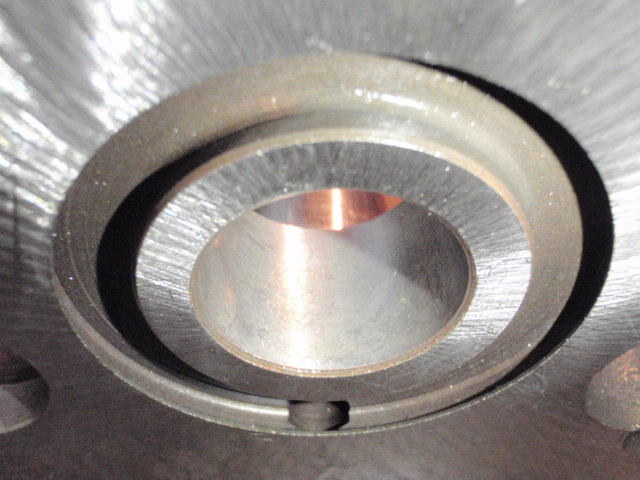

Thanks to all for the help. I've attached pictures for anyone who doesn't have parts to look at. I think this is the oil passage in the case teaser was referring to- also the bearing carrier with a mating hole in it and a picture of the extended nose on the starter sprocket with the seal.
Now I remember reading thet Honda replaced the roller bearing with a ball bearing- was there a hole in the ball bearing outer race to use this oil passage?

<<<<<<<<<<<<Now I remember reading thet Honda replaced the roller bearing with a ball bearing- was there a hole in the ball bearing outer race to use this oil passage?>>>>>>>>>>>>
The Ball Bearing replacement for the Roller Bearing on the right side (91002-259-020) DOES NOT HAVE THE OIL HOLE the Roller Bearing does.
As it is an OPEN bearing I suppose it doesn't need it as plenty of oil will splash into it. ............lm.
