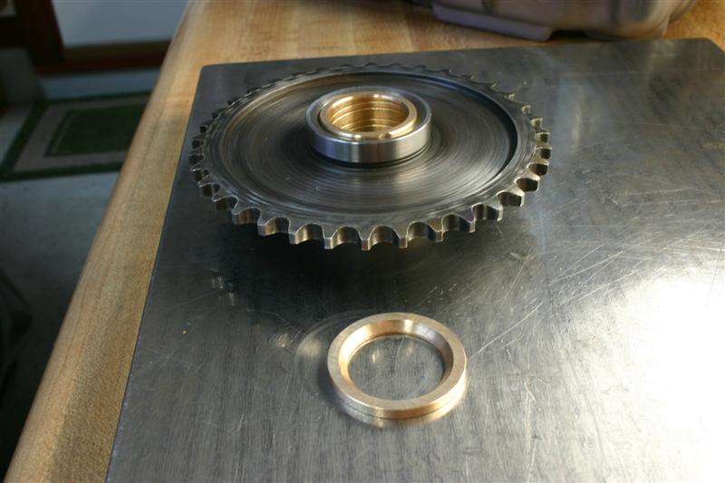

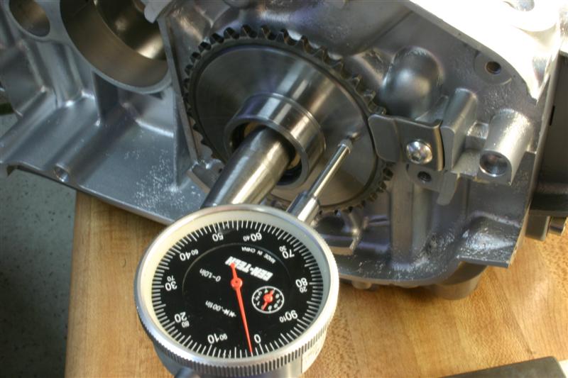

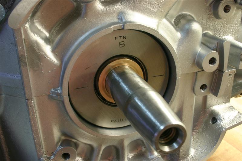

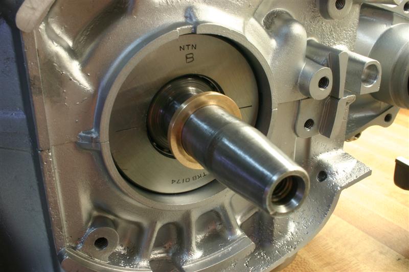

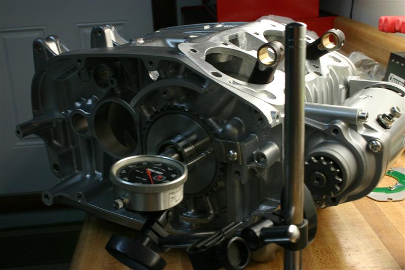

While I'm working on the stator end, I picked the best of 5 sprockets I had, and made a new bushing. I noticed all had considerable wear on the bushings. After looking at the wear patterns, I came to the conclusion that the alignment between the starter sprocket and the crank sprocket really needs to be very good, or else the sprocket stop [the small die-formed steel part mounted to the case ahead of the crank sprocket] will exert force against the outboard edge of the sprocket and cause undue wear on the sprocket bushing. The sprocket will not go outward [it's against the stop], but will move inward, and ride against the engine case. I measured .013" back and forth movement, and I believe, from wear patterns observed on all five sprockets, that the starter motor sprocket will pull the crank sprocket around.
I remedied this, first by aligning the two sprockets and then taking measurements to make an oilite thrust washer that fits against the crankshaft shoulder on the inside. The center of the crank sprocket will run against this washer and limit the inboard movement, the factory stop limiting out board travel. This will eliminate the axial torque against crank sprocket - I also gave it about .003" travel. The oilite material will take oil from the crank bearing, and fits well within the seal diameter; I also had to put a 2mm chamfer on the washer where it clears the shoulder radius of the crank. I stoned and polished the seal surface of the crank sprocket as well.
