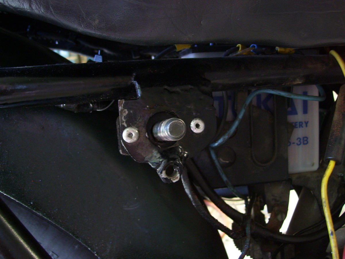

This is interesting as my bike frame does have the flange shape to the ignition switch mount + some other welded on bits from previous attempts to keep the side cover on without the correct retainer! Having another look though they could be a later modification to. I have attached a picture maybe you can tell me if it looks incorrect ! The pop rivets are through the flange holes and the large bolt has a cupboard knob currently keeping the side cover on. I have a simple toggle switch under the cover for ingition. The hole in the side cover is 24.5mm and this would be the best indicator of the switch type I need. Do you know the hole size used on the early and later models?
Modified ignition switch mounting !

Post by Goodbrew » Sat Nov 24, 2007 8:02 pm
Me again ! You may be interested in my frame number it is CL72 1000235 this puts the bike in the same year but supposedly before the switch modification.
