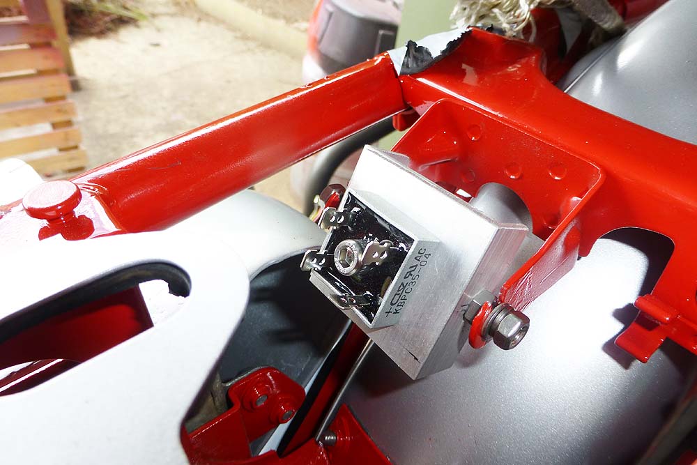

Many thanks for your replies, just popped out & bought a similar one to the Radio-shack one, £2.50 (about 4 bucks) , cobbled up a heat-sink bracket from 3mm alloy angle & mounted it ok, I will make the connectors to suit when I make the new harness.
Its a 35A unit, but SHOULD be ok.

Nice job on the install!
