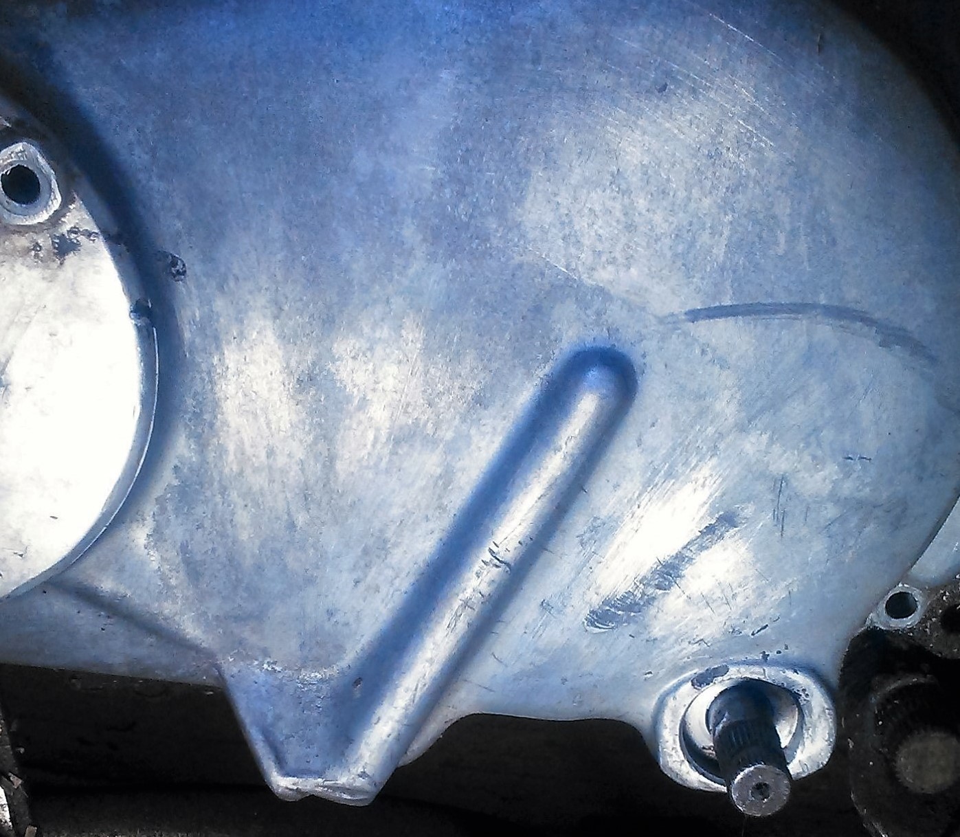

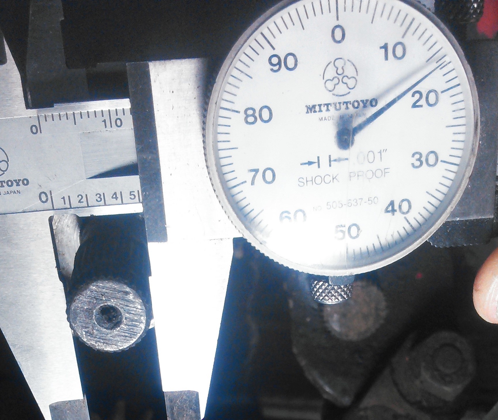

CA77 Shift Shaft Spline size with Photo
Post by randioury » Sun Jan 24, 2016 8:10 pm
Engine No.: CA77E-1026086
Frame No.: CA78*1026149
Caliper dial reads 0.5165"
305 clutch cover (5).gif (377.92 KiB) Viewed 2703 times
305 shift shaft (2).JPG (486.97 KiB) Viewed 2703 times
Re: CA77 Shift Shaft Spline size with Photo
Post by LOUD MOUSE » Sun Jan 24, 2016 8:31 pm
Your bike is not a 1961 but is a 1965+ bike.
Your shaft at the clutch cover looks good to me but the splines look stripped to me.
Now show us the lever which you have and say doesn't fit. ................lm
randioury wrote:Engine No.: CA77E-1026086
