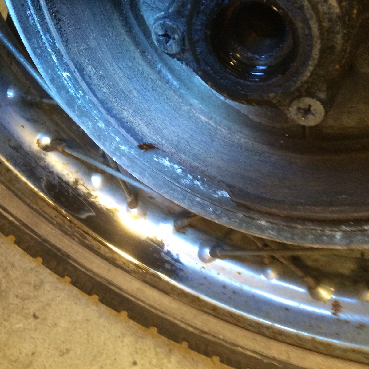

Post by Seadog » Wed Feb 18, 2015 7:04 pm
I took my rear wheel apart today and found this hunk of brake liner missing. The brake shoes were fine. Can this be relined, or will I have to find a new hub?
OldScrambler
Posts: 283
Location: Wisconsin, USA
Post by OldScrambler » Thu Feb 19, 2015 12:58 pm
Not much surface gone...................file / sand the edges..........if your just keeping the bike on the road. May need to clean-out the hub a little more often. I would look for a better hub if doing a restore.
How did it get that way?
Posts: 1273
Location: Cape Cod, MA
Post by Seadog » Thu Feb 19, 2015 1:24 pm
OldScrambler wrote:Not much surface gone...................file / sand the edges..........if your just keeping the bike on the road. May need to clean-out the hub a little more often. I would look for a better hub if doing a restore.
Thanks. If it can't be relined somehow, I'll look for a better used hub. I won't use it the way it is.
Based on the overall poor condition of the bike, I can only assume that it got that way from 50+ years of neglect and/or poor maintenance. I've owned it for a bit over 1 month. It won't stay that way.
