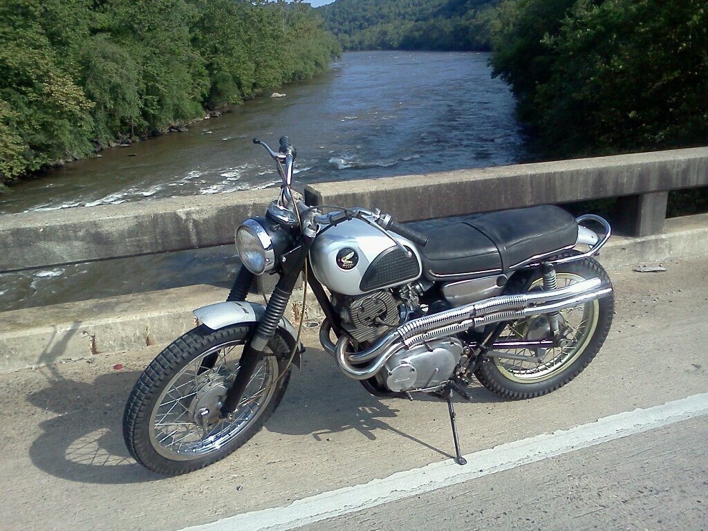

Here is a glamor shot.
Posts: 5681
Post by G-Man » Sat May 09, 2015 11:13 am
That's a pretty tidy-looking bike. I can see that the rear fender is an aluminum one. What's the front? What year?
