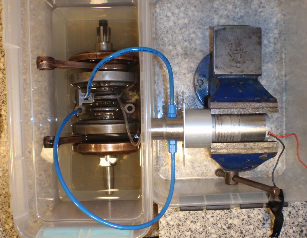

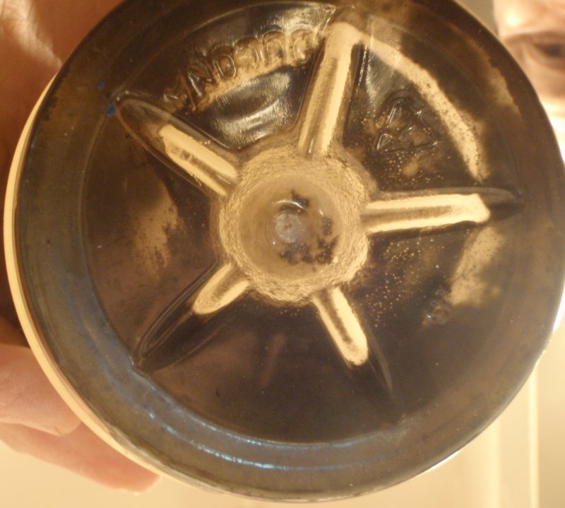

If the crank is within specifications, I flush the crank over a period of weeks, sometime months, interspersed with ultrasonic baths. This is a CB450K0 crank in solution.
Fluids I use:
petrol, thinner, alcohol, degreaser and sometimes more aggressive stuff.
In the bottle, all the stuff from one crank is gathered. This crank only had around 1500 miles on it, no more. The crank was within spec, so no pressing needed (this time).
I do this with all my cranks, sometimes it takes just a few days, sometimes it takes months to break up layer after layer. Especially when the PO's used oil with Zinc Diakyl Dithiophosphates, these layers can be very difficult to solve. The pump is a high pressure gear pump, driven by a 24V motor. I press the tubes into the oil feeds. In the beginning the pump is sucking the fluids via the big-end into the pump untill the bigger chunks are gone, then I switch the tubes and press the fluids through the oil feeds for days.
When possible, I clean the passages mechanically first (pipe rag), also the centrifugal area is cleaned mechanical (this is possible with the CB450 K0 cranks).
Fluids I use:
- black sludge in solution.jpg (53.69 KiB) Viewed 3128 times
- black sludge on bottle bottom.jpg (81.29 KiB) Viewed 3128 times
- spoelen van de boringen.jpg (140.52 KiB) Viewed 3128 times
- spoelen van de krukas.jpg (141.56 KiB) Viewed 3128 times

That requires some patience. Have you ever had the sludge analysed. I've often wondered how much of that stuff is actually decomposed oil.....
