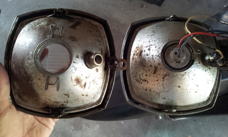

Well now here are the headlamps from the two C78's that I have. The older bike C78 1000088 has the dual locking springclip. The newer bike C78 1001462 has the single clip that is squeezed and holds the bulb in. What's the concensus? One OEM and one not? Both not? Curious.
Dream Headlamps
Dream Headlamps
2014-07-21 17.13.09.jpg (274.13 KiB) Viewed 4548 times

Stanley?
Post by conbs » Mon Jul 21, 2014 6:19 pm
Do either of them have "Stanley" anywhere on them?
Eljeef
Posts: 458
Location: Windsor, Ontario
Re: Stanley?
Post by Eljeef » Mon Jul 21, 2014 8:23 pm
conbs wrote:Do either of them have "Stanley" anywhere on them?
The one on the right with the squeezable spring clip has Stanley stamped on the back. The other one is too rusted to tell. I did pull a Toshiba bulb out of the one on the left for whatever that's worth.
