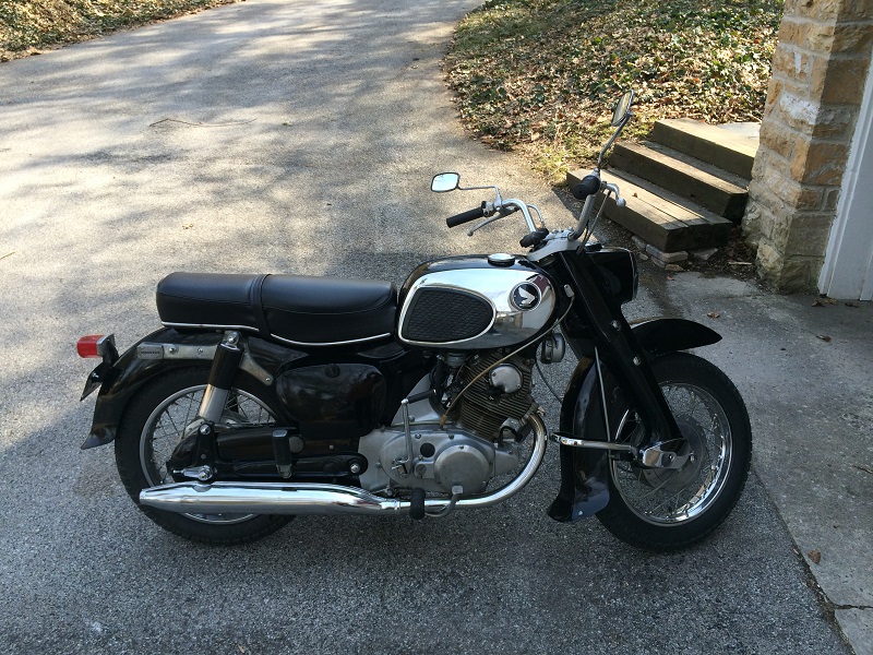

So, after 6 months of repair, rebuilding and more than a few communications with Ed, my bone stock original '66 is back on the road after a 30 year nap.
Life is good, or so I thought. The two small (3/8") rust holes on the backs of my otherwise flawless OEM mufflers blew out to two 2" diameter holes, on a ride this weekend. So, I pulled them off and took them to a local welder who said the metal in either direction of the holes, is like foil and can't be welded.
I could use some creative advice on repairs/replacements. I realize that there are $1,150 NOS OEM replacements out there, I am trying to avoid that option, if at all possible. Thoughts?
