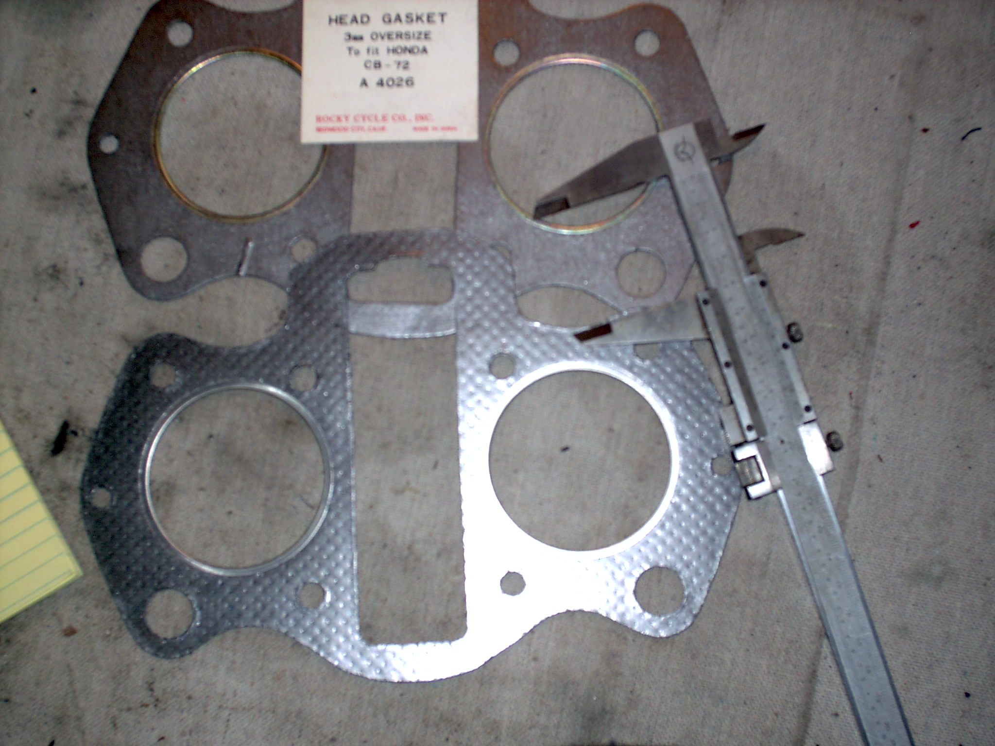

my thoughts as well. lets say you have a stock bore, the std head gasket is 1--1.5mm above that. so now with a +3mm 250, the bore is 57mm, stock 305 gasket is 61mm +/-. so instead of 1-1.5mm over, now the gasket is 4mm over the bore. still plenty of bearing on the steel mating surfaces(I think). I wonder is there some variation between different brands of head gaskets as to I.D.? find one with the smallest I.D. and try it? the actual 250 +3mm gasket is a little hard to find.

Thanks Kevin, awsome service. for anyone interested, after hearing from both LM and Les Barker that "maybe" a stock 305 gasket might work, here are a couple measurments. the Rocky +3mm gasket = 60.15mm, so 3.15mm over bore. the stock 305 (DK) gasket =62.5mm, so 2.50mm over stock bore. so my thinking here is that the stock 305 gasket might work at 5.5mm over bore. anybody have a real Honda gasket to measure?
