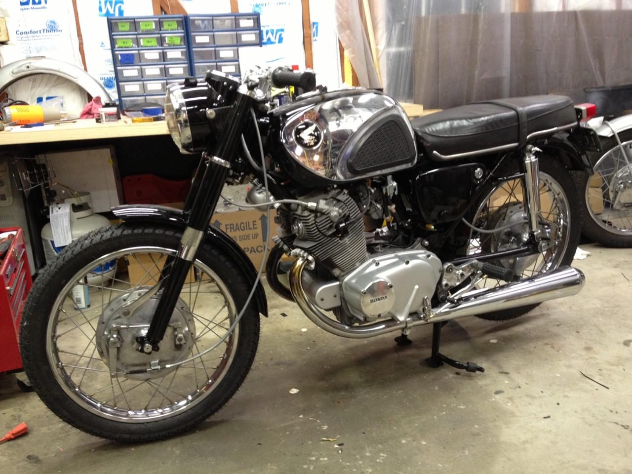

With a final push, I got my SuperHawk back together and running (picture below). As you may have noticed, it's not exactly stock, the unrestored bike had been pretty heavily butchered, chopped parts with multiple coats of paint (gold and magenta on top of the original black, then back to black), so rather than go for the stock look, I cleaned up some of the mangled parts and stayed with black and chrome, thus the BlackHawk...
Anyway, the motor is running beautifully, I have run it around the neighborhood and it really pulls cleanly with surprising power (especially compared to my Dream, but ya'll already knew that). I put a Sachse electronic ignition on it, no points or advance springs (yay!), but a fairly loud clicking can be heard when running at a constant speed. The clicking goes away on accel or decell, or when I pull the clutch in, which probably makes it a clutch or transmission thing - so I probably posted in the wrong section, but hopefully someone will recognize the behavior. The clicking is not at the engine speed but slower, and is quite pronounced, which is disconcerting, especially since it's running so nice, i really want to ride it, but don't want to trash something that's about to go.
Any insight is greatly appreciated!
Thanks,
Jack
