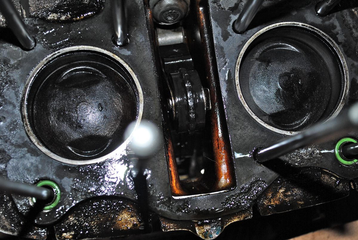

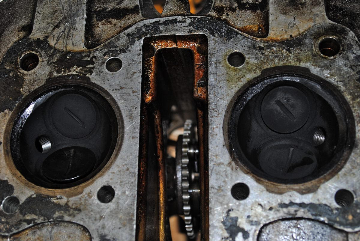

A) I'm posting some pics of the cylinders and the valves as I saw them when I split the head.There's no overt scarring or dents, just a lot of oil and carbon, but I have no expertise in these matters and I might be overlooking a serious issue. If any of you would be so kind as to look at the pics and share your assessment, it would be invaluable.

You're right, sliding those jugs back onto the pistons take patience and dexterity, but it's not too difficult. I like to have some way to hold the pistons steady and A strip of aluminum with a slot in teh middle to clear the rod is a great tool, but not absolutely necessary.
Compressing rings can be a pain, but assuming that ring gasp were checked first, It's not impossible. Some people like to use ring compressors which are a strip of flat steel which holds the rings tight while the top is slipped over the piston.
Again, really useful but not 100% necessary. The guy that probably fitted more pistons than the rest of us is Loud Mouse.
That's quite a lot of oil. The loose nuts were probably the cause of the blown gasket - insufficient clamping force. That has also allowed oil to pass out the front and to make a mess there.
BTW, the only place you should need 3 Bond is between the crankcase halves and if they're not to be split, then it can stay in the drawer.
I would pull the barrels off and inspect the pistons and rings. As RW mentioned, it's very possible that the rings are worn. If there's a lot of dark stain below the bottom ring, then the rings (at least) are worn.
Remove the pistons, clean the tops with a wire brush and/or Simple Green and degrease the barrels and then let's see what the skirts look like and you can measure the wear. These are pretty simple engines. fabulous design for the times but nothing too complicated.

YA received good advice from RW and teazer for sure.
I expect the rings are worn out and from the pic ya need a new cam chain tensioner. ........lm

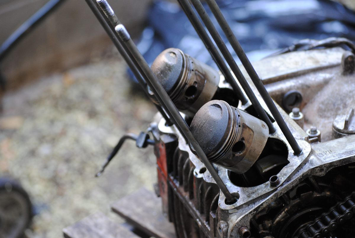

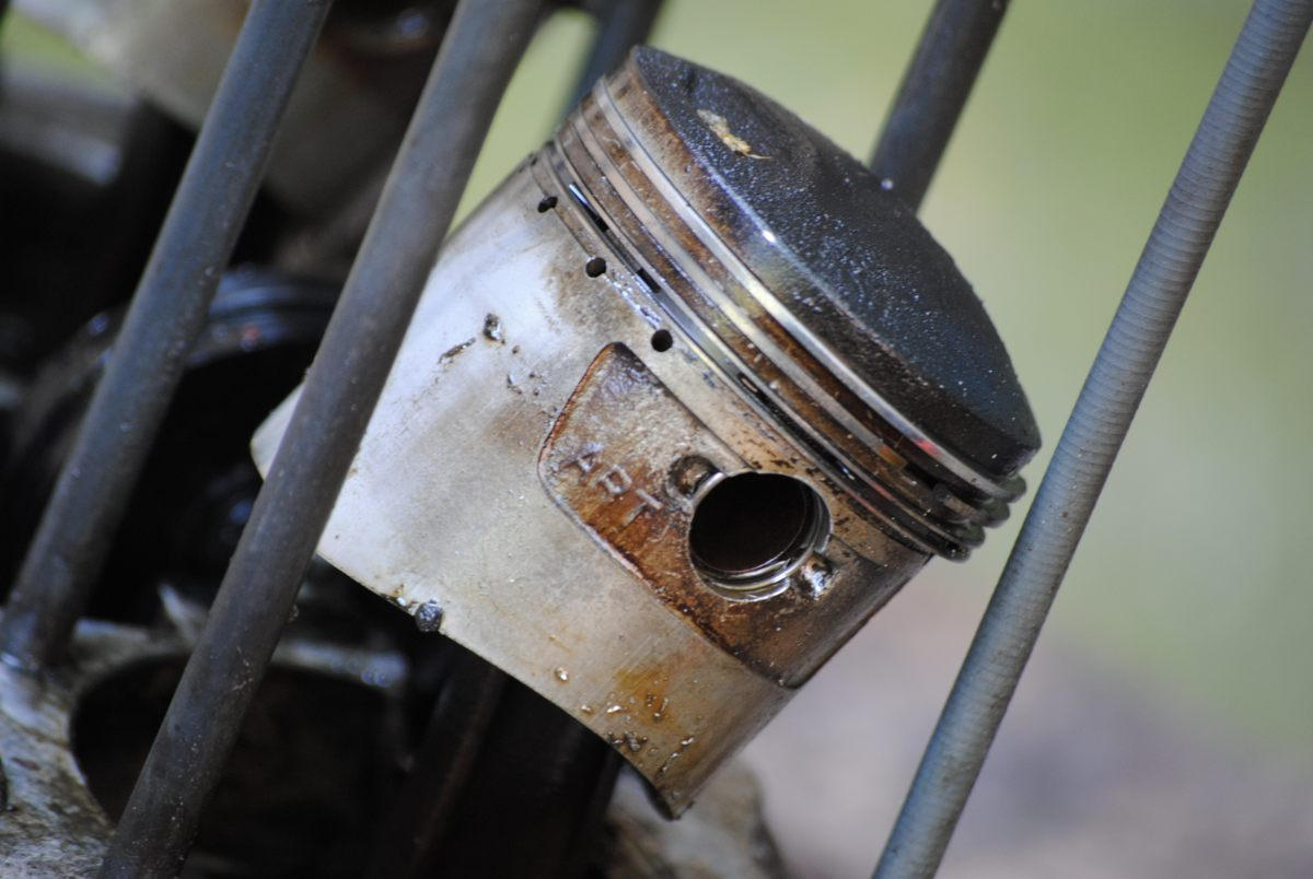

PS: Here's some pics of the spare engine pulled from a '65 (NOT the one I'm currently working on, which is from a '63). Just so I have some basis for comparison, how would you rate the condition of these pistons?

Here is where the rubber meets the road as they say. It is entirely possible to hone the cylinders,install new rings, and put this engine back on the road with minimal expense. I say this because I've done exactly that, but then I have the micrometers to measure the parts. Since you don't, it complicates things a bit. You need to determine exactly what the bore measures out to and then determine what your next move will be. A good machinist can tell you that. All this is relevant to just getting this thing back on the road. For a good quality rebuild that will last for a while, you will have to go the extra mile and pay a machinist to bore and fit the pistons to the cylinders.
The re-assembly is quite easy and we'll guide you through it. On these engines the block is lowered onto the pistons. I do it one ring at a time, some may have a factory compressor cone and one fellow used a radiator hose clamp to compress the rings, then tap the block down onto the pistons. Once in place, the clamp is removed. Pretty clever I may add.
Now, here's some food for thought about your head. Again more choices. To evaluate the heads needs, I prefer a simple test to determine my next action. I position the head so that two ports are upright. Pour a 1/4 cup of gasoline into the valve ports and if you have no moisture around the valve seat itself, I say they are tight enough for service. Do the same for the remaining two. A weep would be OK and a seep or more needs attention. Then you may want to whisper sweet nothin's to LM and see if he'll do your head. I hear he does a stellar job.

RW, thanks for your reply. All in all it seems fairly straightforward and I feel confident that I will be able to tackle this project with minimal stress. So far I've really enjoyed it- especially as I tore down that '65 engine previously and since knew better what to expect.
I'll post pictures soon and see what you think- to my eye the pistons and cylinders looked pretty clean and free of scars or irregularities, but if I have to have the engine honed etc I can't think of anyone whom I'd trust more than LM to do the job.
