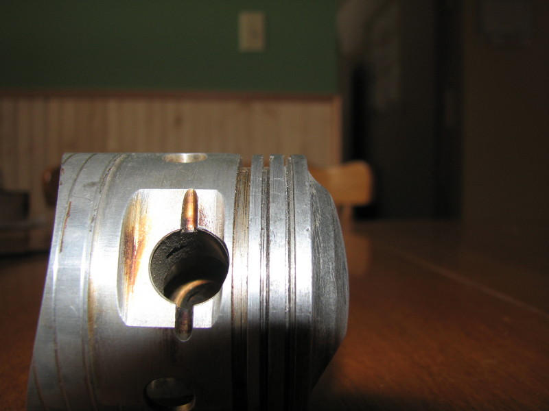

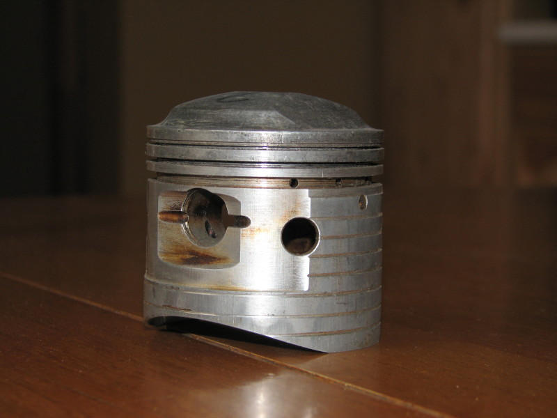

I have attached a couple of pictures of one of the pistons. The top ring is a "Dykes" style ring. I have also done some measuring of the piston and I include this here.
OD of the piston on the skirt - 2.516"
OD of the piston where the rings are - 2.506"
Overall height of the top groove - .065"
Height of the inner groove for the top ring - .031"
Depth of top groove - .125"
Height of 2nd ring groove - .06"
Depth of 2nd ring groove - .125"
Height of 3rd ring groove - .11"
Depth of 3rd ring groove - .125"
