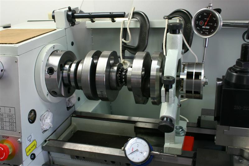

Turned the rotor on the crank - was out .0035" radially, about .0015" on face, actually not bad; since the set-up takes more time than the actual cutting, I just took a skim cut to get it true.
Honda 305 Stator 002 (Medium).jpg (65.04 KiB) Viewed 2450 times
