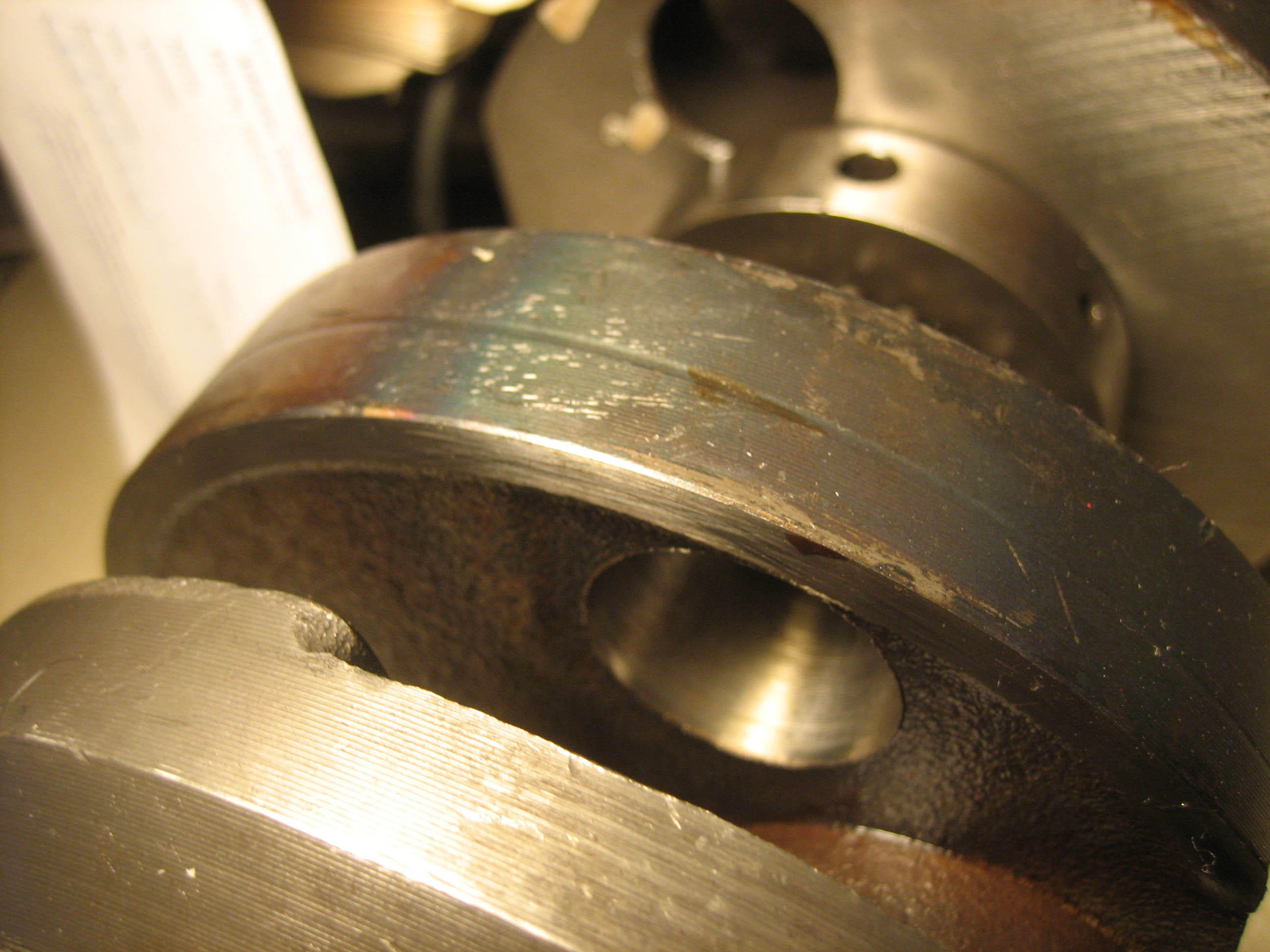

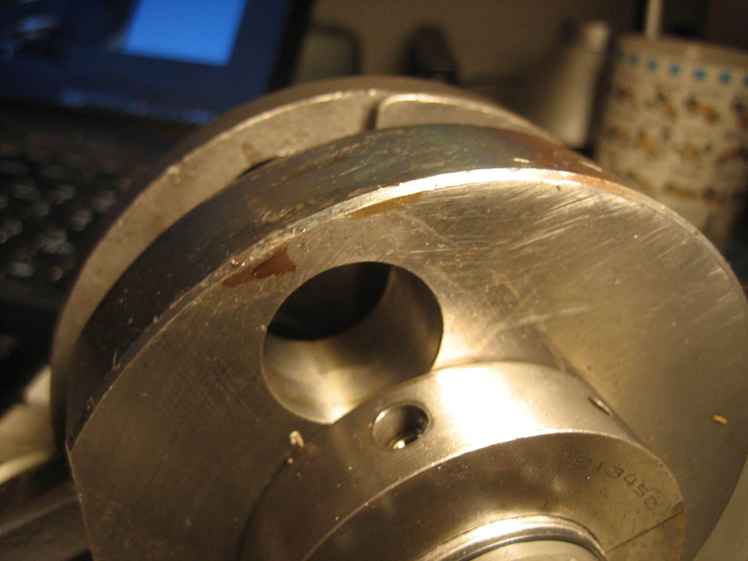

And the part of the crank with the blue part we're seeing seems to be around a lightening hole. Is it blue near the big end pin, or just out there? Since it's the web on the inside, the implication is that the inner bearing on that side may have a problem.
If the blue appears to have originated at the center pin or the big end pin, I'd strip the crank and inspect the bearings. If it's just around that hole I'd was things out with WD40 and see how the bearings sound.
You were right. I'm a knucklehead. That is the right side of the cylinder head we're looking at.
As for the blued crank, under good light I can now see that there is a band of bluing that wraps the hole in the crank below the blued surface we were looking at in the previous photos. The odd thing is that it is only visible from the rough cast side of the crank (first pic). I can't see anything on the other machined side of the crank weight (second pic).
As for the bearings, the inner bearing on the blued side of the crank doesn't seem to have any side to side slop. Both inner bearings slide off of their roller. In other words I can slide them along the shaft until they hit one of the center sprockets on the crank.
I'll post some pics of the pistons. The skirts had a lot of fine scoring, one particularly on the front and back, but they were otherwise undamaged. The color ranged from black to yellow. No heavy carbon deposits.
Anyway, that's a lot of information. Basically, I'm interested to know if that heating pattern indicates something in particular?

My take on it is that the heat effect you are seeing on the crank was done before the crank was machined. There is no evidence I can see of overheating or excess temperature since it was run. I'd replace the outer crank bearing if it's worn and refit the crank.
I'd like to see pictures of the pistons. side top and inside the crown if possible. That will tell us a lot more about what happened and may point to "why".
You mentioned scratches and they are usually caused by dirt rather than a seizure. Black and yellow sounds like a hornet or an ugly bruise, but not so common on a piston. Pics might help there. What are the barrels like - fine scoring signs of seizure or looking good?
Q - Could it have been that main bearing failing that caused the rough running and feeling like it was seizing? Is it damaged in any way or are the balls or cage blue and was it a roller or ball bearing? One of the outer mains was changed from roller to ball and that may have been a cost cutting or it may have been that they needed more flex and a balls are cheaper than Superblend rollers.

The bluing (very hard to see)is indeed due to the production process.
The reason why Honda changed to ball bearings was probably due to the fact that the surface of the crank (where the pins run onto) gave problems after a while (the hardened surface tends to break of the inner soft material, this process is called pitting).
If the surface is pitted, you will need a new crank, but Honda thought of a cheaper way to fix that, with the bearing (cheaper for the customer).

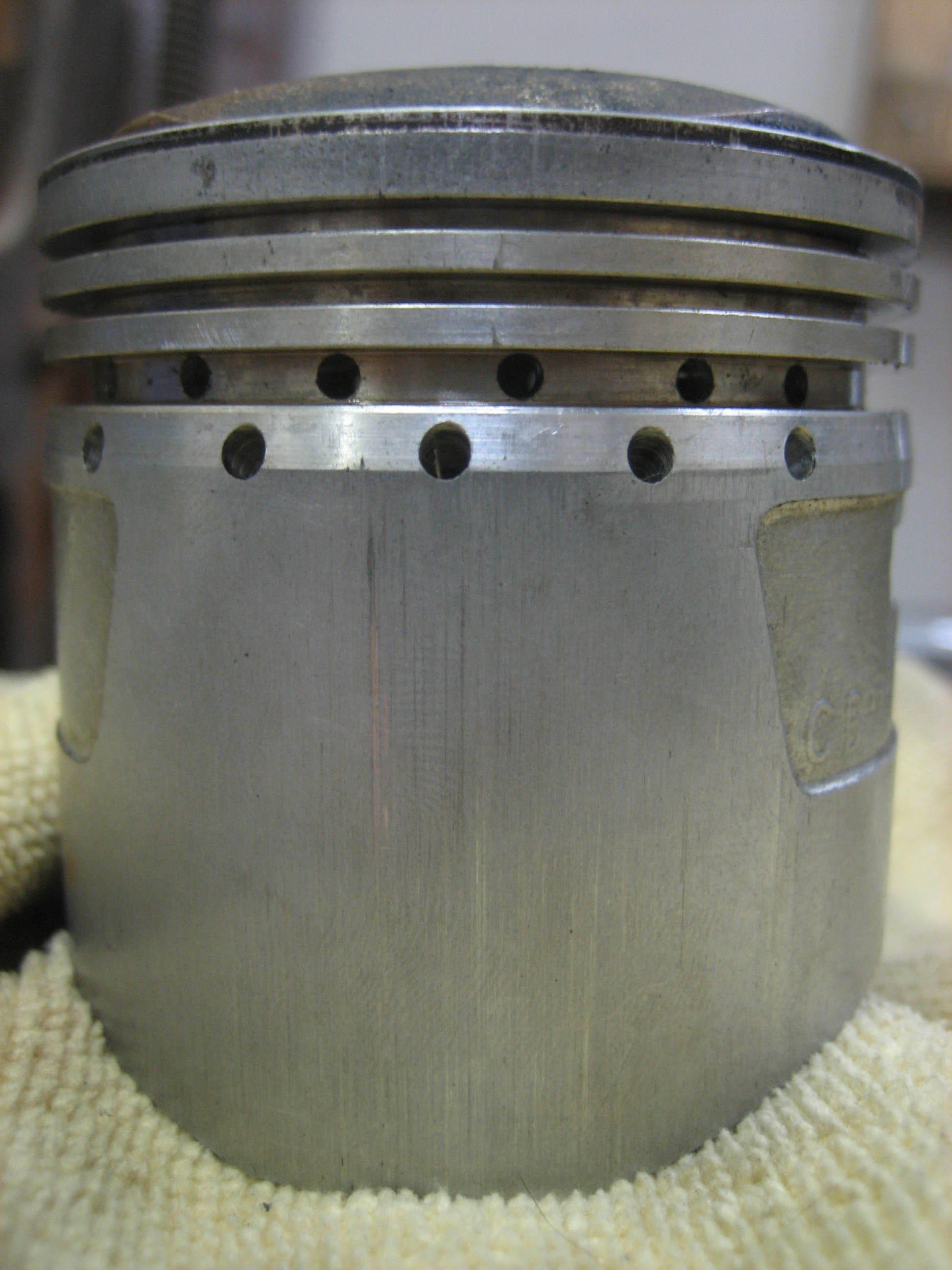

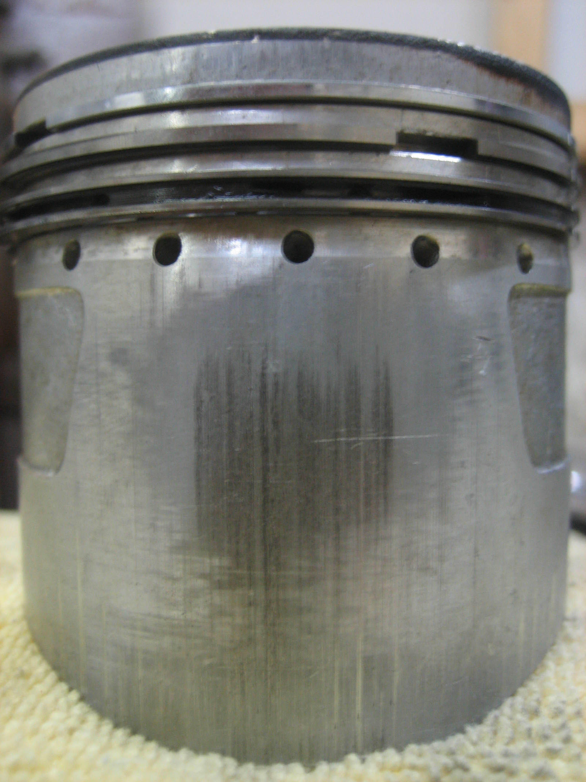

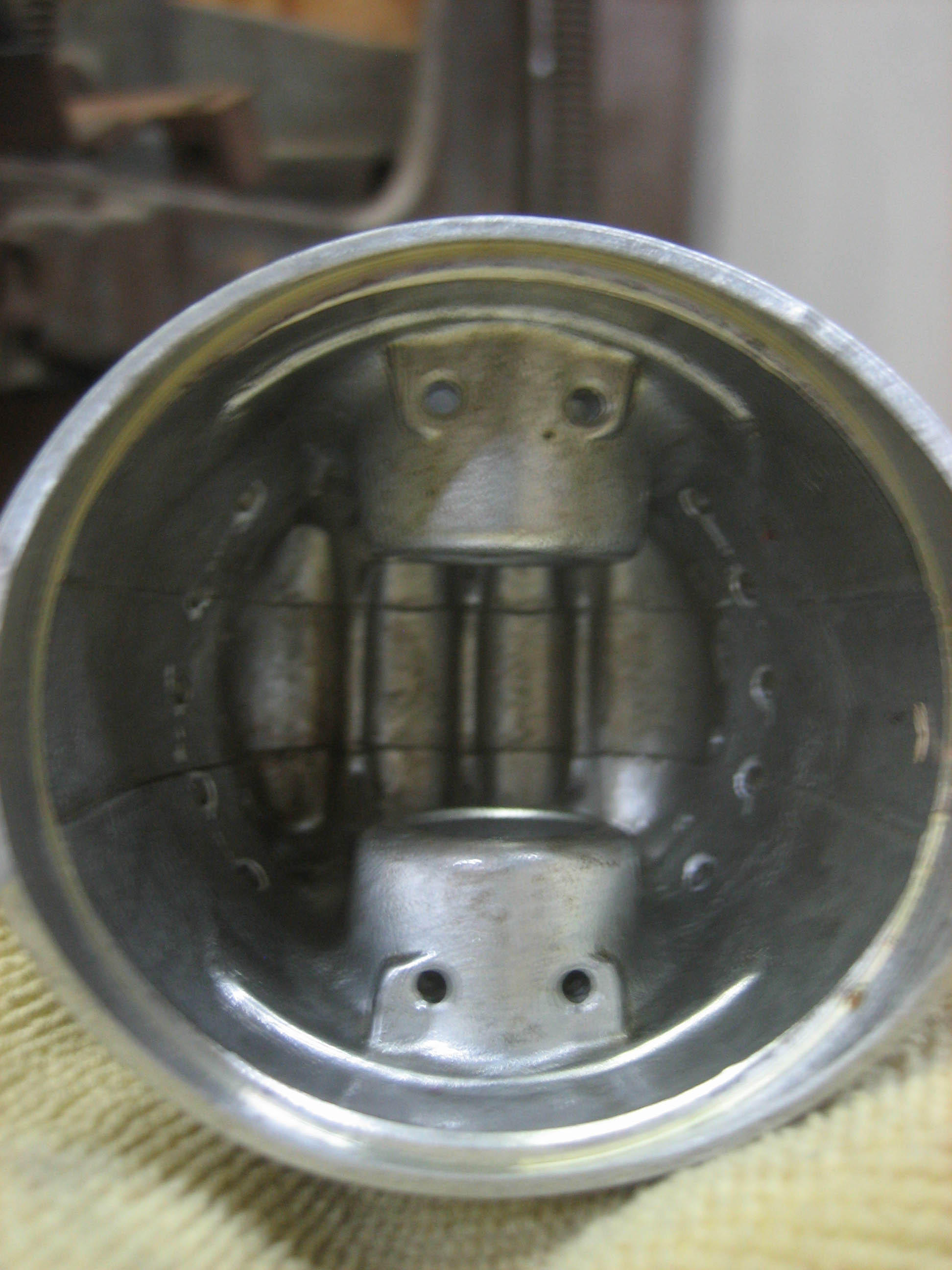

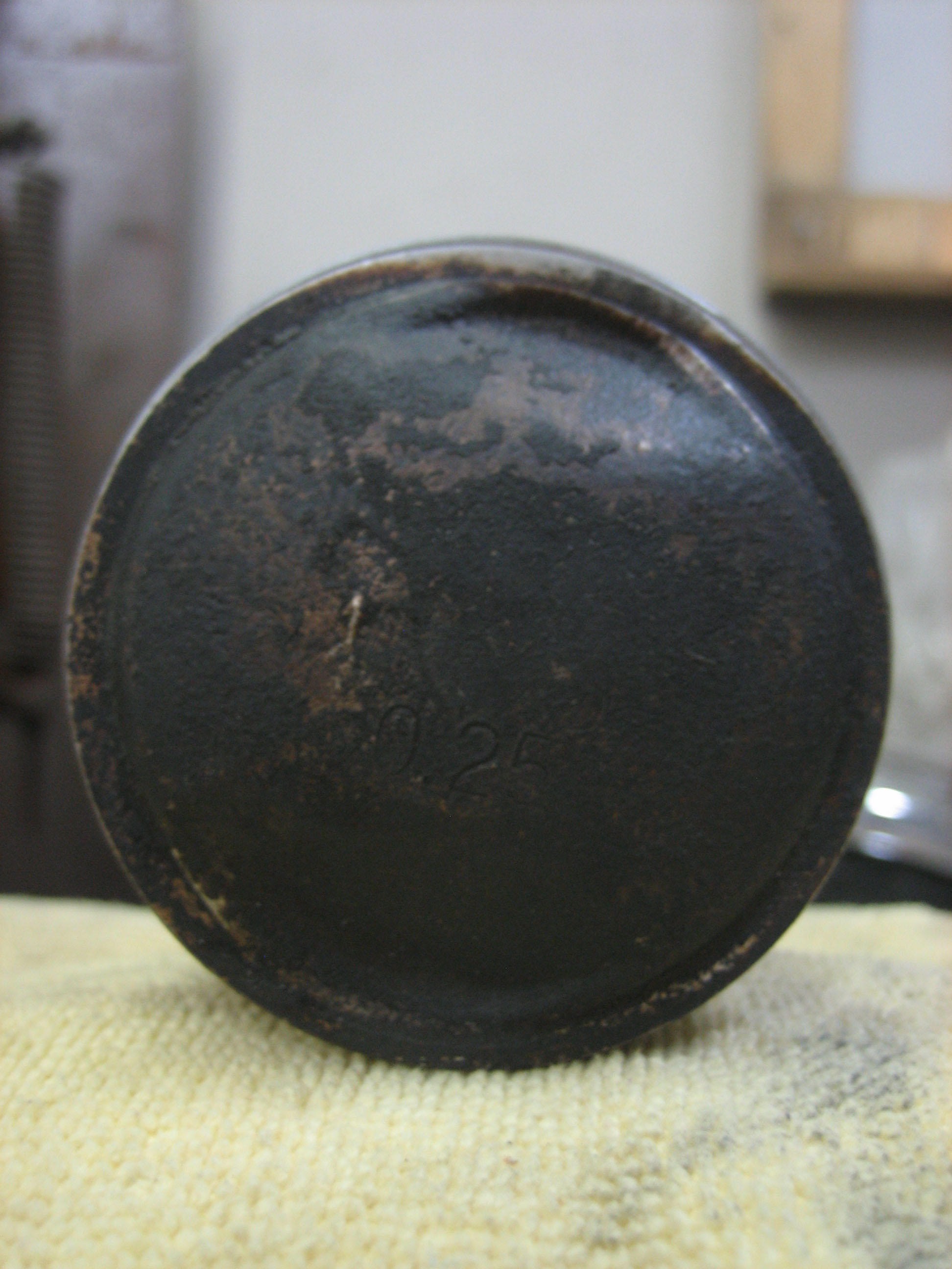

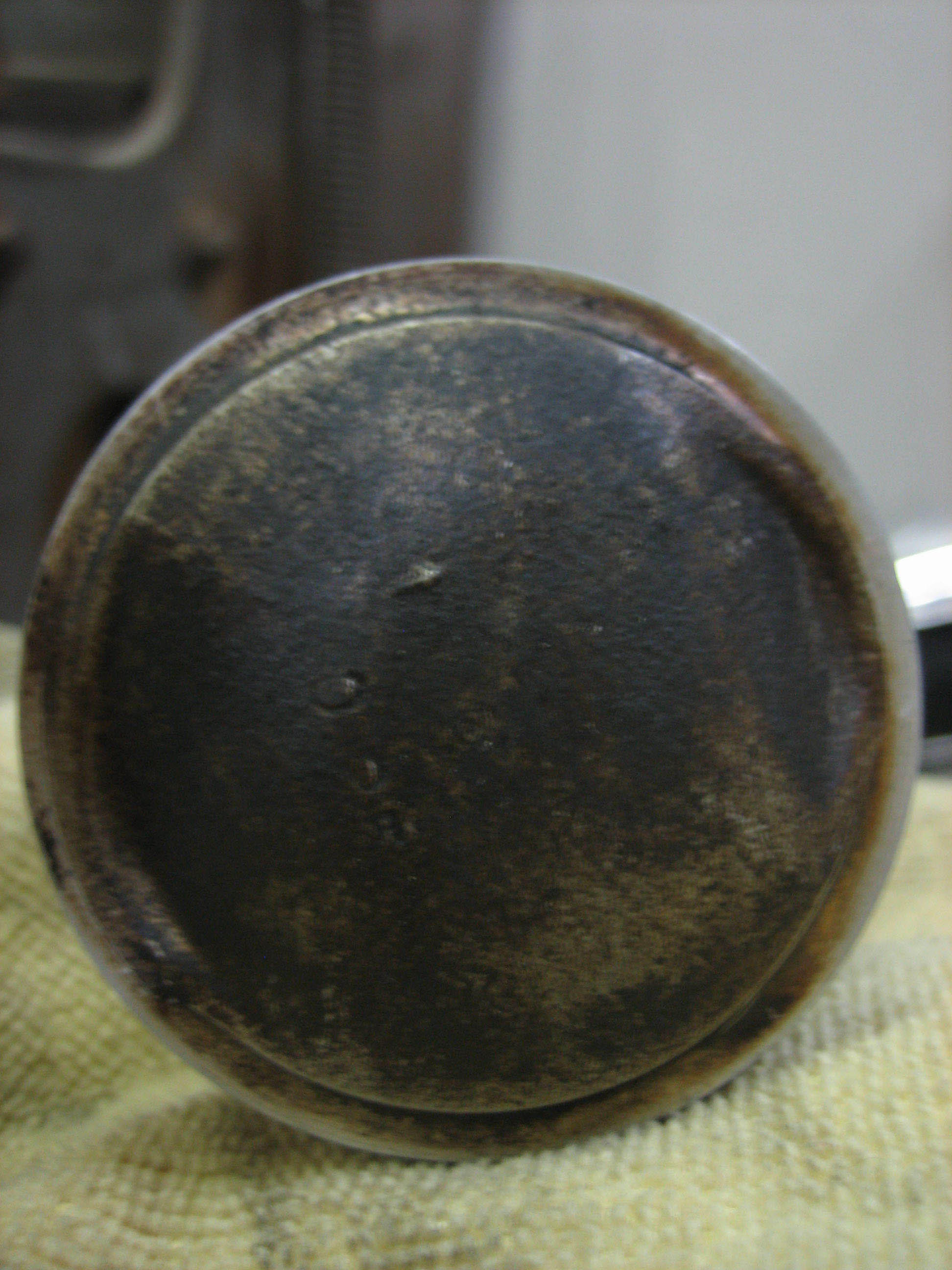

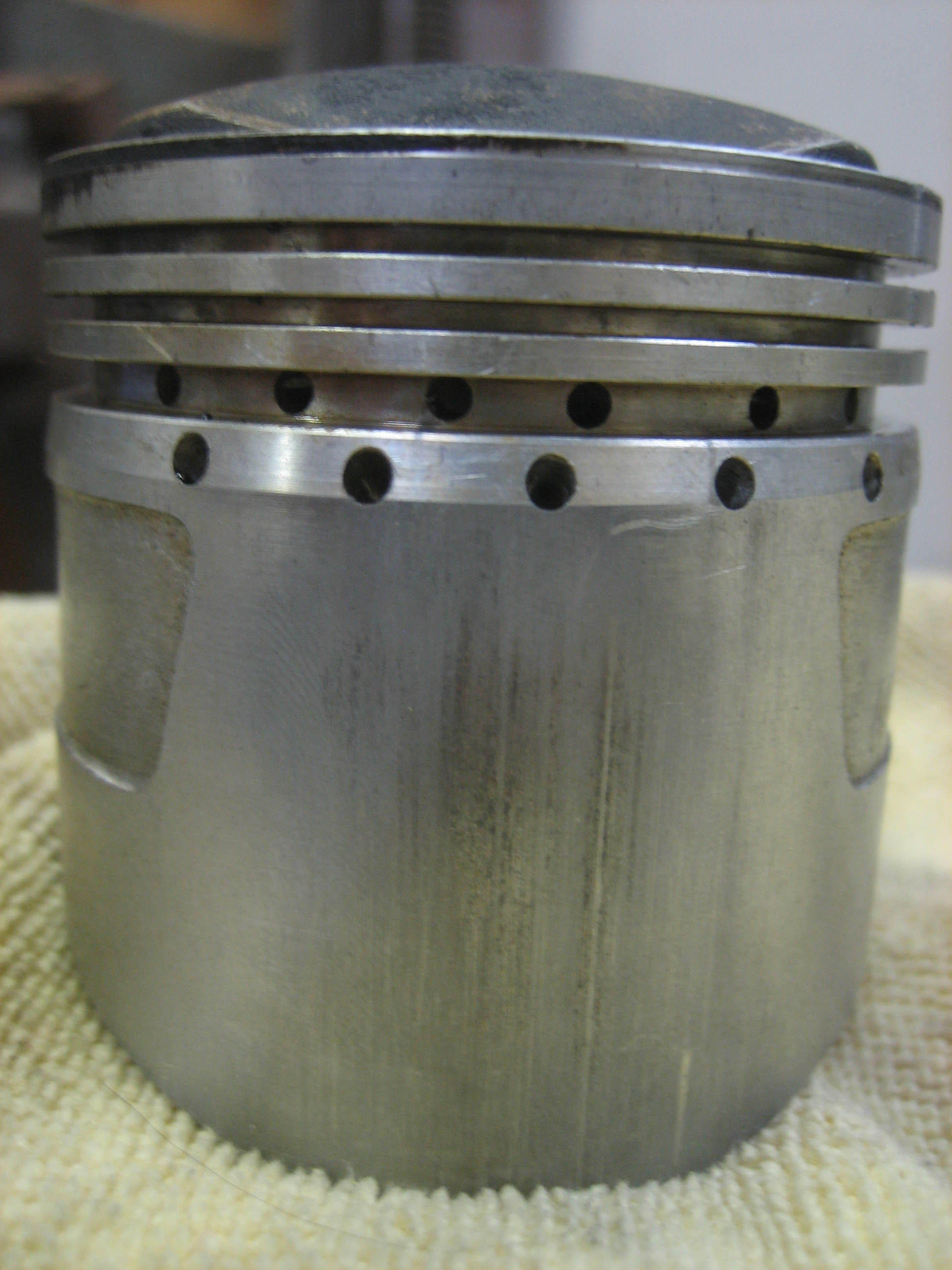

Here are some pics of the pistons. To try and limit confusion here's four pics of the first piston: top, front, rear, inside. I don't know which side it came out of, but it is the less scored of the two and my assumption is that it came out of the less marked up cylinder (the right). I'll create another post with the second piston.
Thanks,
nander

Post by nander » Sat Oct 16, 2010 12:19 pm

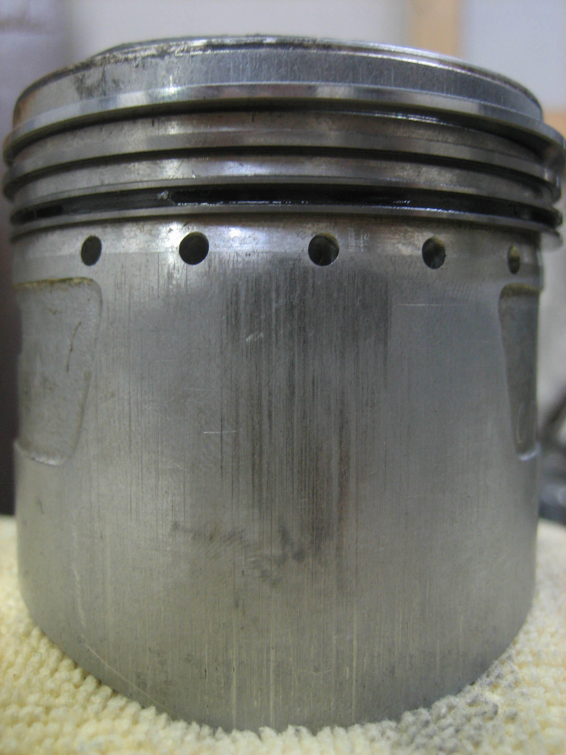

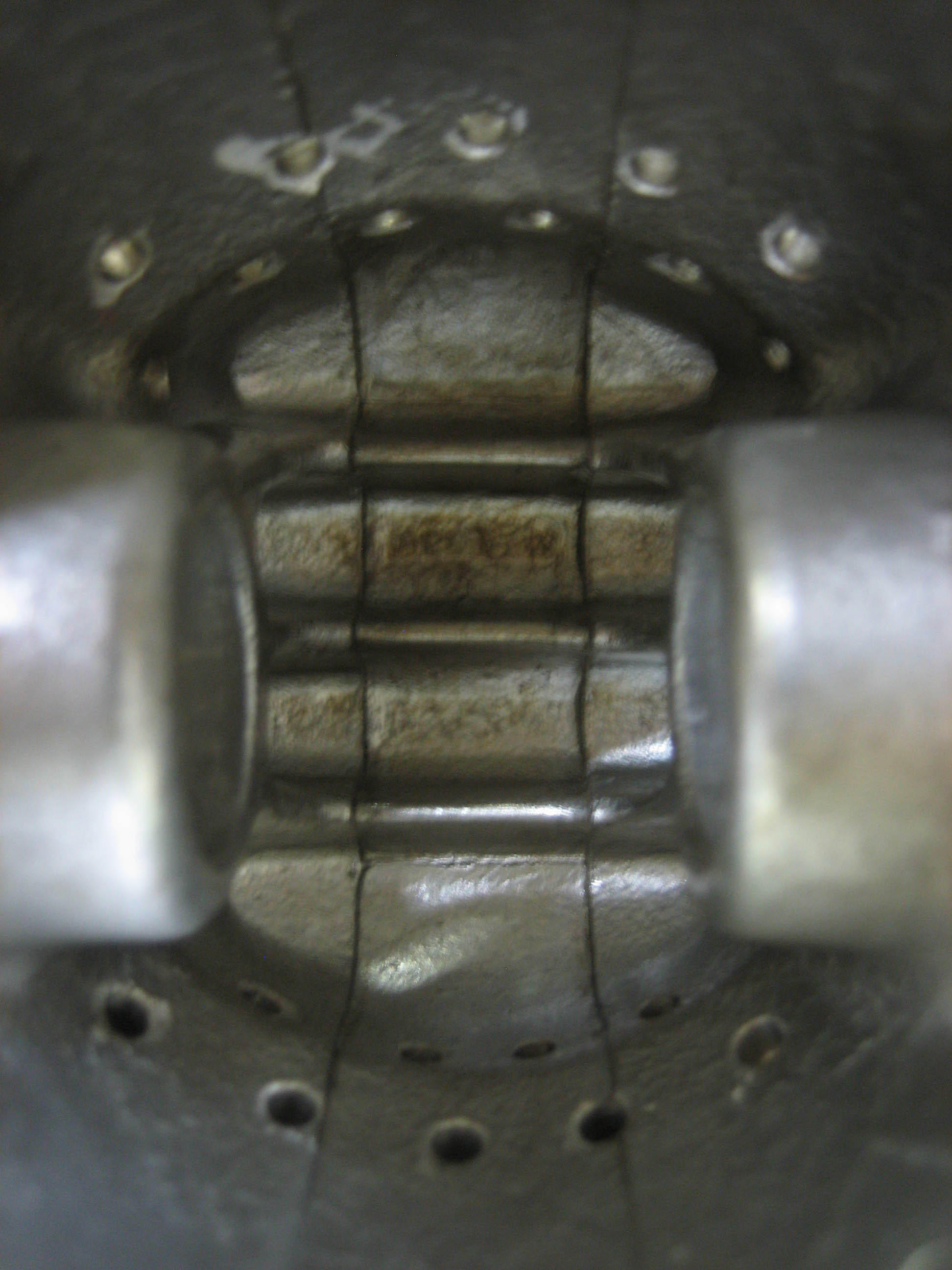

Here's pics of the other piston. This one is more scored and the top is a little crustier.
