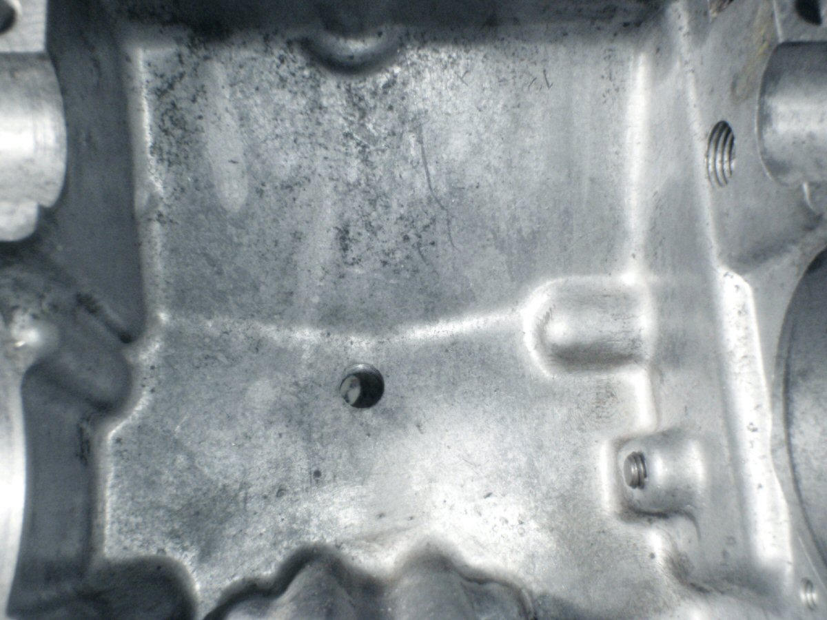

I SAID LOOK AT THE """""""""""""INSIDE"""""""""" OF THE CLUTCH COVER as the subject was a line in a engine case.
So ya have a line in a case and ya are going to your METAL EXPERT feller and test for a crack.
OK..
I don't talk in riddles at all.
I have apx. 35 clutch covers and ALL have casting LINES on the inside which to some would look to be cracks.
Well ya take a little time and a piece of sand paper or similar and ya will find that CRACK is nothing more than a LINE in the casting.
Riddles your donkey Jensen!!!!!!!!!!!!!!!!!!!! ............LM

First of all thanks for your opinion about the "cracks", it confirms my presumptions.
A dear friend of my is a metallurgist, and he's always interested in such questions.
Yes I admit, I could have done that, but that would destructive research, if an expert looks to it, better leave it untouched.
I don't understand the expression "riddles your donkey", but I'm sure you meant it either positive or in a positive humorous way.
Talking in riddles is more a Dutch expression, I have to start thinking more international.
As stated in my previous mails, I am always looking for parts which differ from the standard. Add that up with my insatiable hunger for information, knowledge and mix it with perseverance and stubbornness and the result is me, an irritating and annoying person who always want to know everything until l reached the bottom (self knowledge is a good thing). As long as I document this gathered information and people are interested in it I will continue to do so.

The lines only appear in the (at least which I have) more modern cases, the 11200 259 030 and on. The early cases (at least in those I have), these lines are not there. Loud Mouse, can you confirm this ?
In the three types of lower cases for the dry sump I found non of the lines.
Loud Mouse, do you happen to have a clutch cover with the small diameter oil filter cover in it ?
Could you look in one of these, and see if you find the same lines in it ?, I'm really interested in what you find.
I grabbed a clutch cover with a small diameter oil cover hole, and I didn't see any lines at all.
After your mail I looked in a more modern clutch cover (big diameter oil filter cover) and found indeed the lines you where revering too.
Could you please confirm this ?
Jensen

For the cases I have in my possession, I have the uppercases as well.
The uppercases have the engine number, and with a little help of the parts list I could track down the Honda part number of the cases.
So you're partly correct, but I used the part lists as verification, the engine numbers as input.
The conclusions written behind 11200 259-050 and 11200 259 060 are partly experience (at least for the CB72 / 77, and partly from parts lists (CL72 / 77). The conclusion implicates that ALL cl72 / 77 cases have a primary tensioner, can you confirm that from your experience with the CL72 / 77 models ?
I found that all early cases don't have the V-shaped lines in it, and not all later cases have the V-shape in it. That implicates that Honda used several production facility's or lines to mould the cases, at least for the later ones. The V-shape line is like a fingerprint for a mould.
The early cases are better moulded, the quality is higher, I also have a few engine cases of a CB92 (1959), the quality is very high, higher then the late CB72 /77. That means that Honda already started to compromise between quality and quantity.
The quality of the CB92 can be compared with the quality of the C70, C71 and C76 cases I have.
I included a picture of such an early case, take a look at it closely and compare with a later case.
Jensen
