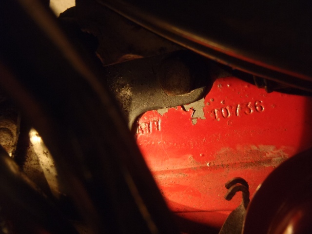

I apologize for being off topic but since we discussed Honda Serial Numbers on this thread earlier, I wanted to share a pic of my frame number. Doesn't exactly align with Honda's list...but maybe that's not so unusual? MGH

Based on the list in G's first post, it looks like a '61 frame, probably titled in '62. Wiring harness will probably say 1961. I like the spirit of taking it back to original, and having it in your living room. I just came in from a 50-deg shop. Married?

I think I read the Honda list wrong. I took the title literally assuming the frame numbers were on the left and engine on the right. I see it now. Thanks! MGH
