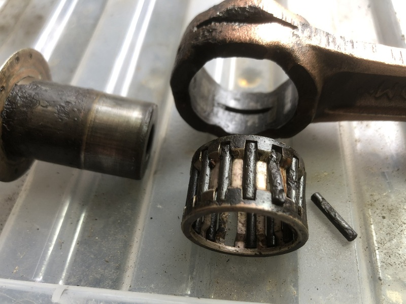

While I agree with all the advice given regarding flushing I just thought I’d share a photo from a crank from a Yamaha RT2 my son bought. We knew the piston was seized due to corrosion but once freed off and the cylinder removed the crank felt ok and ran smooth with no signs of a problem. Seeing the amount of corrosion in the main bearings we got the crank pressed apart just to be sure, lucky we did! It was dire, yet it felt smooth with no play at all.
