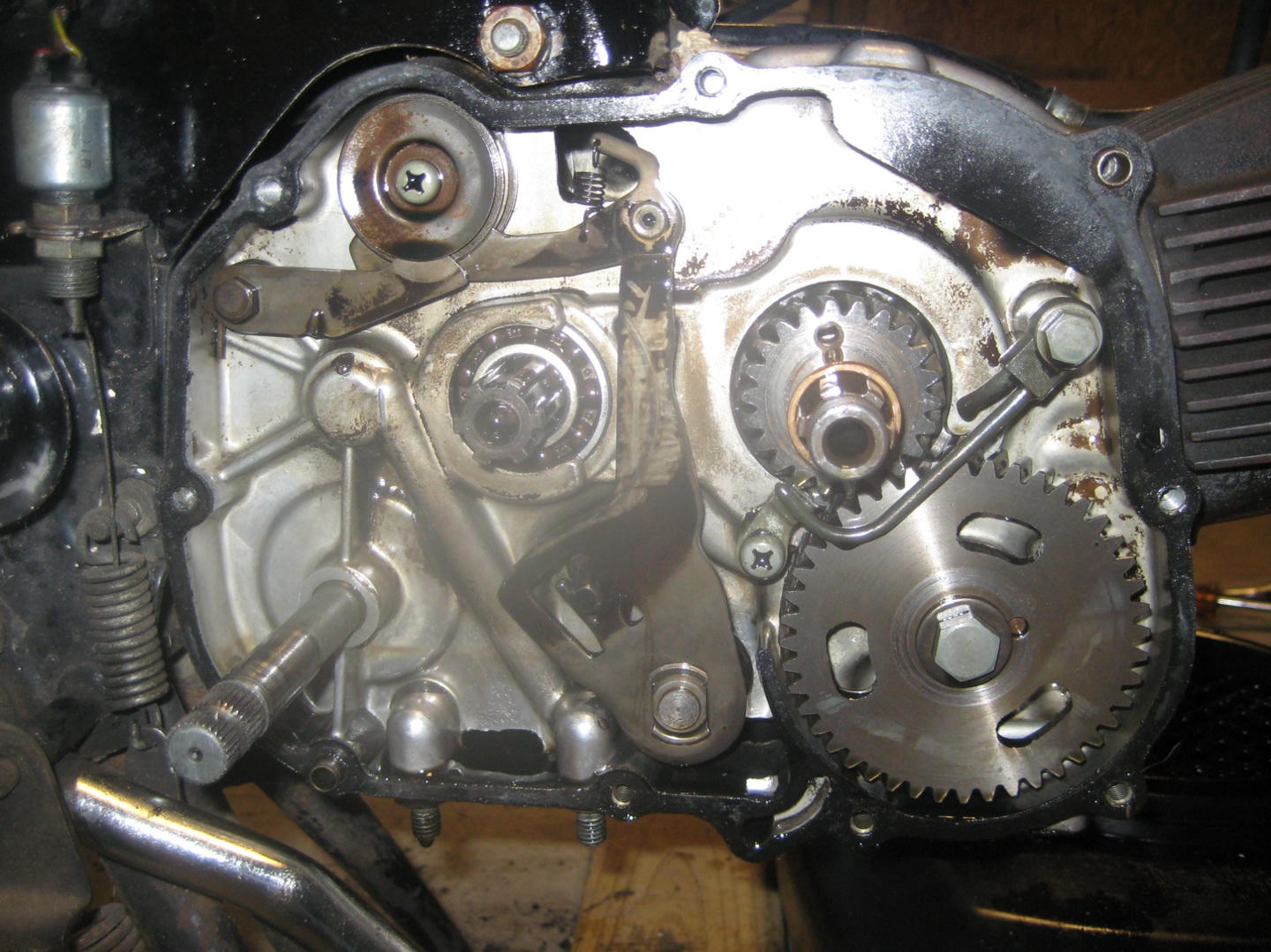

Right Side Transmission Items Look Okay
Post by Freshapple » Tue Jul 08, 2008 1:16 am
Well, I took apart the right side of the bike. I looked at the clutch, gears, springs etc. and everything appears to be in proper order on the right side of the bike. I opened the outer case on the left side of the bike and discovered the stator, generator and other electrical stuff. I think I need to take the next level off the left side of the bike to get to the gears and transmission items. I think this is where the bike is having the issue of not staying in neutral. Even with the right side taken apart (see photo) the bike still continues to jump out of neutral into first gear while kicking the kickstart.
Does anyone know if the electrical items can stay together in order to remove the left side of the gearbox? OR Do I have to remove the generator and stator to get the next cover off to look at the transmission?

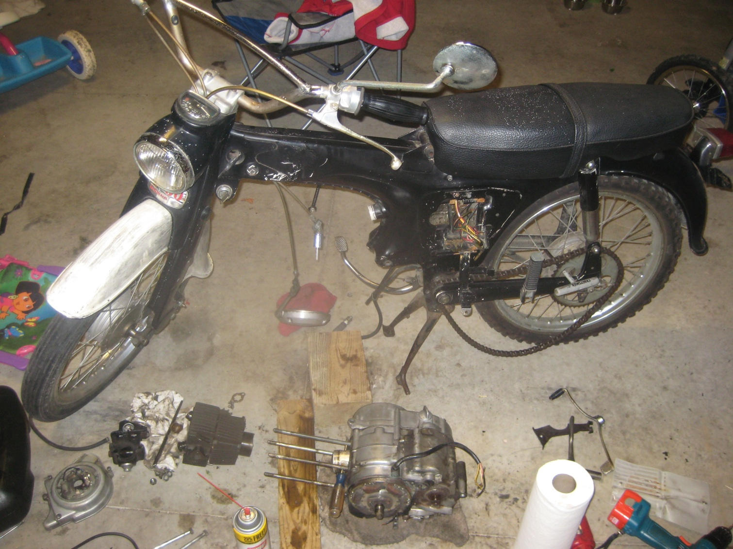

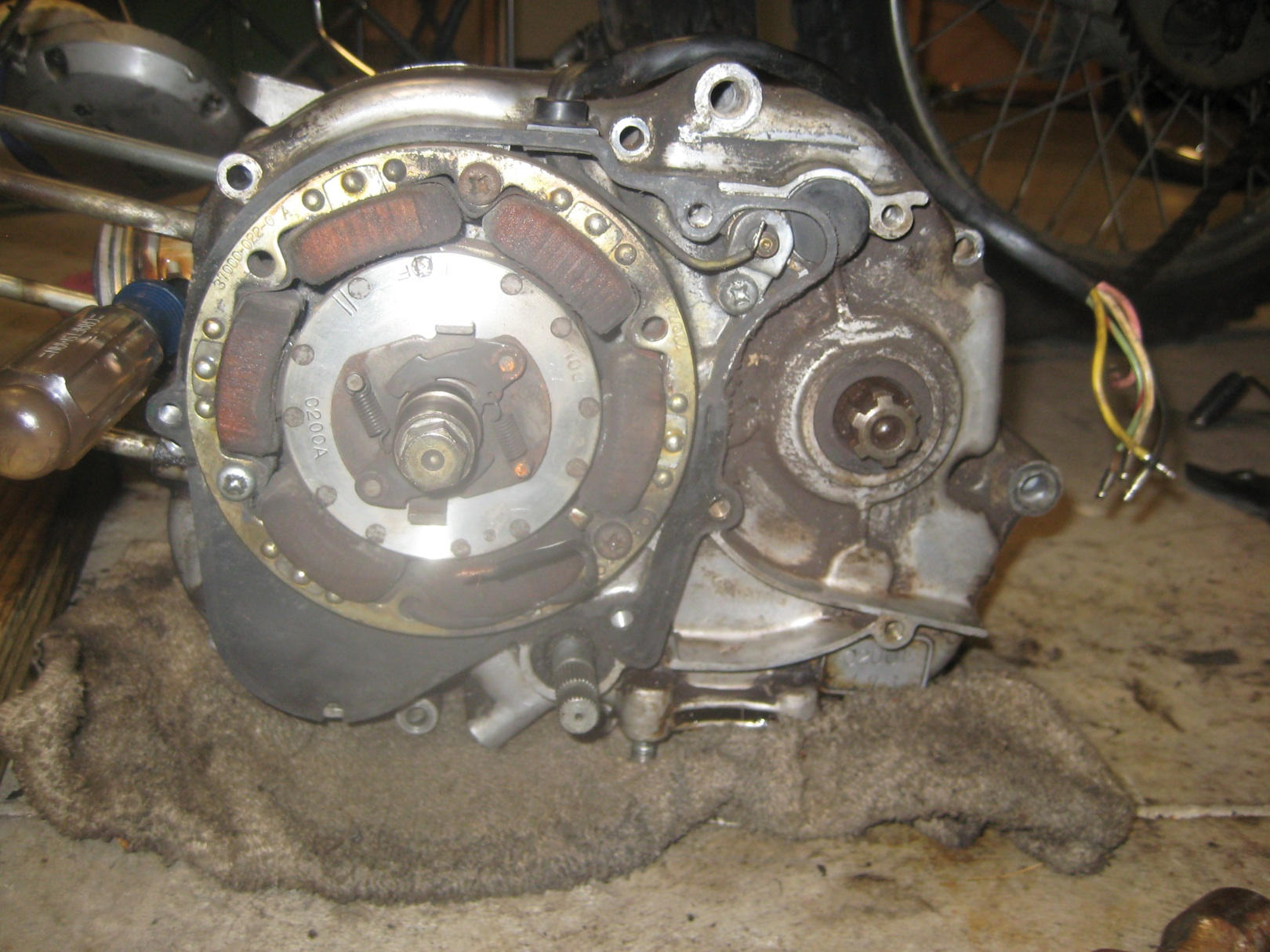

Post by Freshapple » Fri Jul 11, 2008 11:09 pm
So my project continues... I have figured out where the fault is on the bike and why it won't stay in neutral. It seems the 2 shafts from the transmission are not seating properly and the play of the shaft in the crankcase housing are causing the gears to mesh and pull themself into gear. I am going to take the crankcase apart so I can look at the transmission. Once I get it open I will look for worn out washers (part # 13) on Paul's first transmission pic OR possibly even gear 5 that slides on the shaft is hung up or not sliding all the way across the spline...
I have removed the engine and have all the bolts out except for one. The one that holds the alternator in (#15). Once I get this one out I can open the 2 crankcase pieces. My question is this,
Is this bolt a regular righty tighty lefty loosey bolt, or is it threaded the opposite of all other bolts to stay in the crank?
Which way does this bolt spin to loosen?
bolt #15
