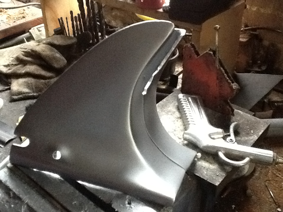

I've since used it to make the carb cover for my bike. It wasn't particularly tidy but cleaned up enough to look OK with a bit of filler and some silver paint

It's great stuff and comes under several brand names. When you say "make a cover" do you mean you cast it with lumiweld? It's pretty expensive stuff for such a big piece.
I have used it for several repairs on my '61 project.
I made it from 3mm sheet aluminium, did the usual cardboard template then welded it together. It took two attempts to get the shape right but the aluminium is easy to beat and stretch to get the double contours. I must then admit to using two pack filler to hide the hammer marks and other blemishes. The materials cost about £4 plus the Lumiweld rods so about £6 in total. I've since repaired a broken casing on my cousins Kawasaki, a very useful product.
