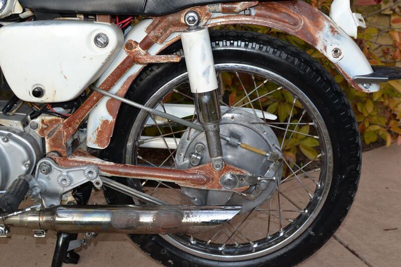

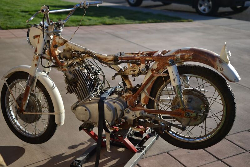

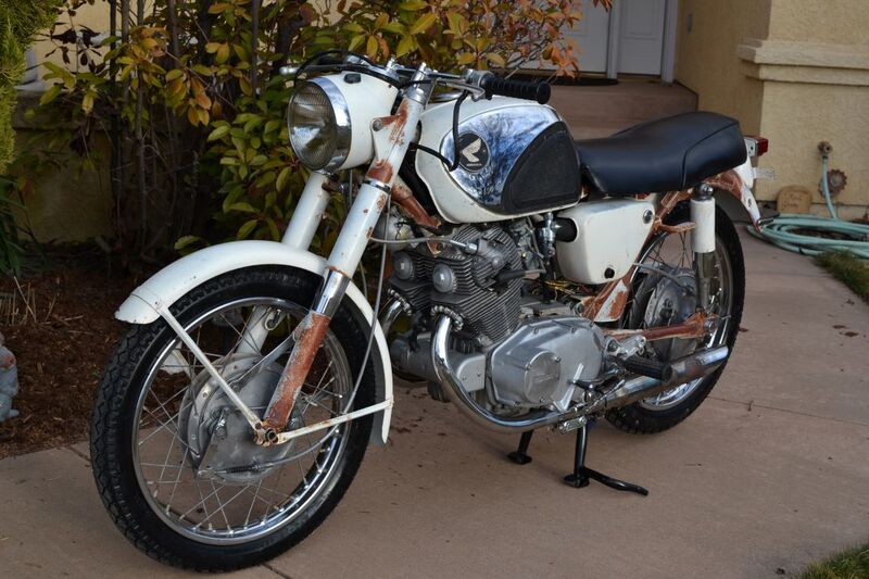

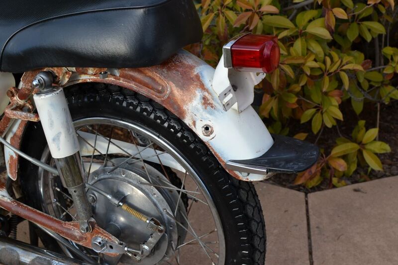

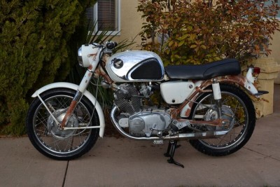

Today was the day that I drove it down the street for the first time. It has been decades since this pile of parts was last a motorcycle. It has been quite a process but I have tried to enjoy the journey and not rush to the finish line. That being said I did want to get to a place where I could find out if I could turn it in to a motorcycle again and I did! The final challenge was the clutch. I must have read most of the posts regarding the clutch on this forum....and there's a lot. Switched over to a five disk clutch basket with a thick Plate A and no wires. I'll let you know after I get some time on the bike to see if it holds up. Turns out the clutch cable/clutch cable sleeve ratio was not allowing the clutch actuator to start at the 7 oclock position. I've found that is critical. I now have a clutch that is working and gears that shift. My regular motorcycle is a Harley softail and the last time I rode a bike like the Superhawk was in the mid 1960's. I feel a little bit like a big kid on a tricycle going down the street. Anyway, I didn't start this project to make a new daily rider. I had in the back on my mind that I might want to take this rustoration to a few bike/car shows around the area. I thought maybe a few gearheads would like to see one of these old bikes again because they are not something you see often. If some people think I am polishing a turd so be it. I've had a lot of fun with it so far and it has got my retirement off to good start. Thanks to everyone who encouraged me and responded to my questions posted on this forum. Here's a few pics.....one from Sept and some from today after putting on the correct tank badge and mudflap. Everything is done except tuning it up but I wonder if a project like this is ever "done".

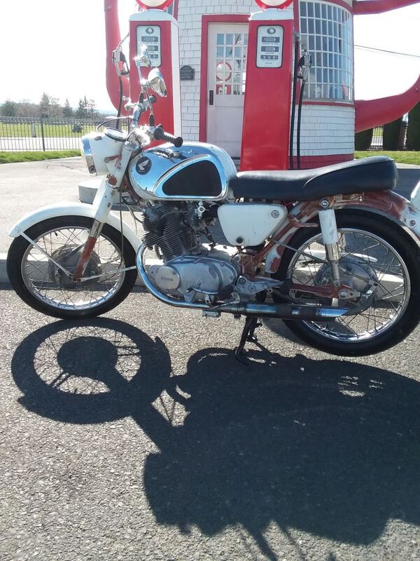

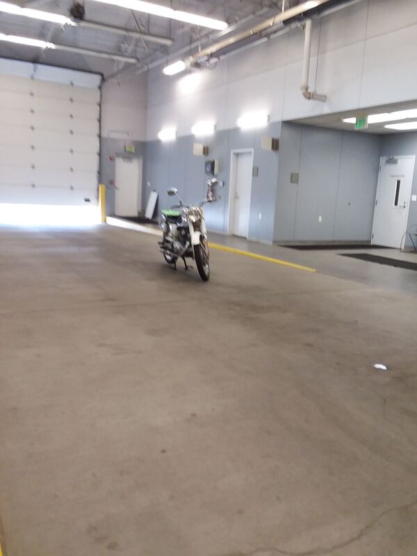

Post by ZillahBill » Tue May 07, 2024 9:36 pm
The next chapter of the CB77 saga is now complete. The bike was inspected by the Washington State Patrol and passed. It now is registered and has a collector vehicle license plate. I rode it 30 miles round trip to the inspection station. Went about 40 mph and it ran great!
