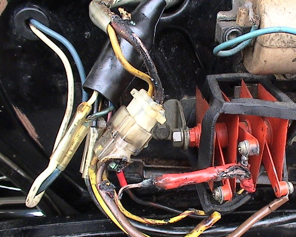

CL77butcher wrote:I have never seen a diode circuit go bad as a short before I am used to a bad diode presenting an open.
I have....here's what they look like:
Note there is no fuze between the hot battery terminal and the rectifier, so if it does short...it is not good!

That would be a Selenium Rectifier, not an SCR (Silicon Controlled Rectifier), which is an entirely different animal.

Wilf wrote:That would be a Selenium Rectifier, not an SCR (Silicon Controlled Rectifier), which is an entirely different animal.
Wilf
Sorry about that...wasn't up on the SCR abbreviation...thought maybe it was "selenium controlled rectifier"
