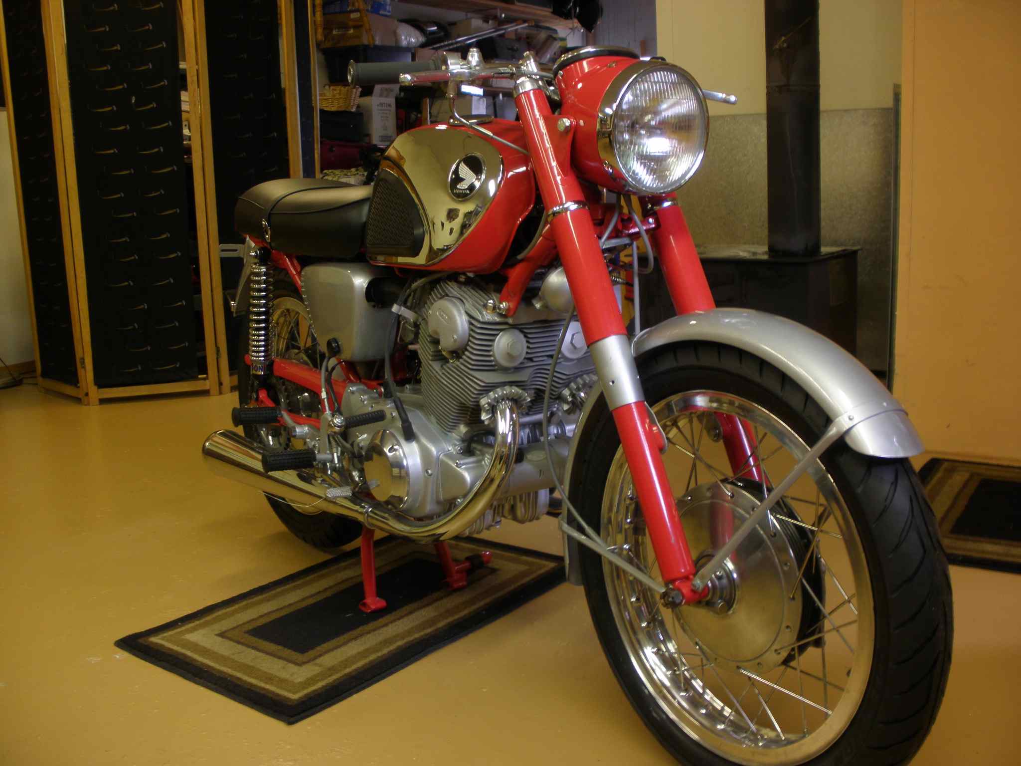

Up in the "Great White North" electric vests are popular and I'm wondering if my '63 Superhawk will support it. As I understand it the superhawks charging system is adequate at best. Not finding a voltage regulator anywhere I assume the charging system is dependent on every load in the system being constant and as prescribed by the factory. Does that mean if I put in a LED tailight that my battery will overcharge? If I want to run an electric vest then If I can switch on that extra charging coil by turning the light switch on but somehow disable the actual light does that mean I could run the vest? Would just converting to an LED do the same thing? So many questions....I'm sure this has never been an issue with anyone in Texas so maybe my northern neighbors have something to say about this. In any event I will try all of the above once I jump through some more hoops to get it registered. Thanks in advance.

i am planning on running an LED tail and head light, the answer is no it won't effect anything as long as you use the same voltage light. cb77's are 12 volts systems, just be sure you don't put it anything under or over 12 volts. you'll be good.

I switched out the stock rectifier for a silicon bridge to improve charging efficiency, and then put in an LED tail light and LED winkers. There have been no overcharging issues so far.
Do you have any idea how much current an electric vest draws? If it's the same or less than the headlight current then you might be able to do the switching you mention.
What kind of registration hoops are you having to jump through?

First, the bike is gorgeous, Wilf. I love the shouldered rims and those Dunstall mufflers are a perfect match for them. Also love the red and silver. I've got the little brother in my garage, an S90 in the same colors.
