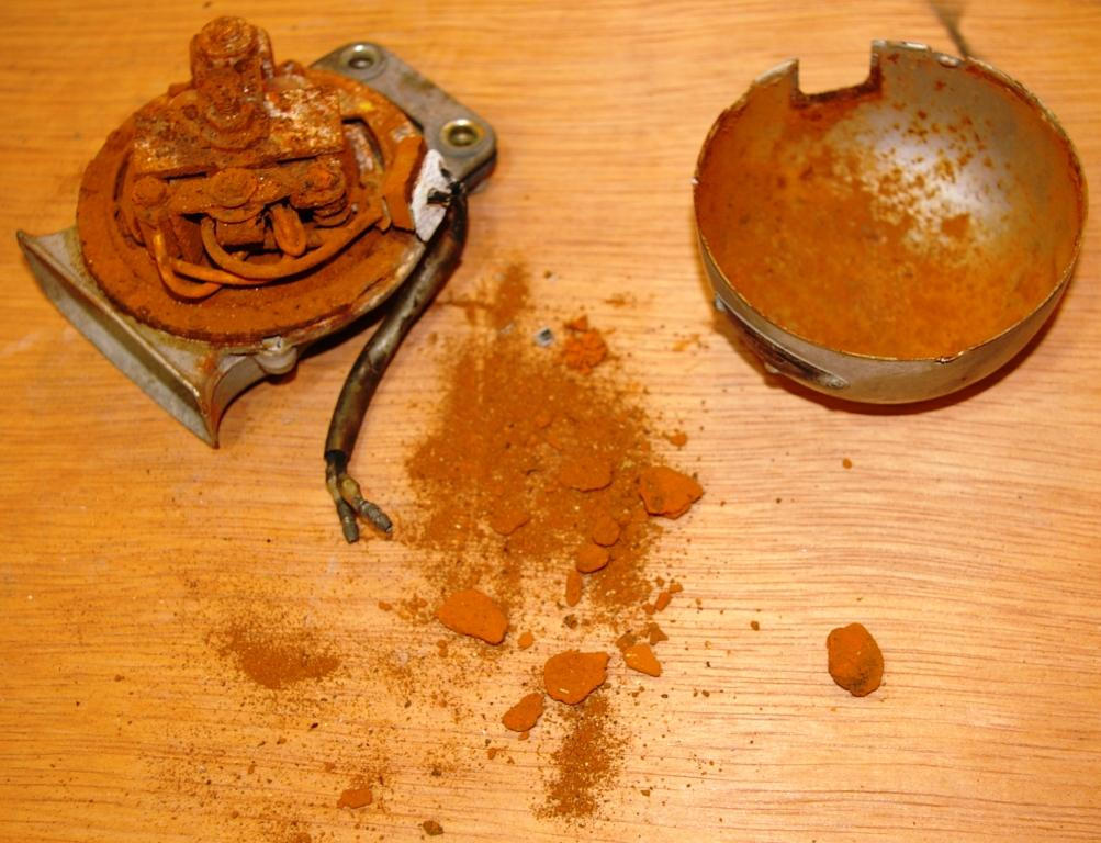

Post by Wilf » Wed Jun 23, 2010 9:31 pm
I take back my second-to-last post! I opened up this spare horn yesterday to see if a broken wire or pitted points were the cause of its failure to make noise...
I'm not sure I will be able to get this working really soon...
