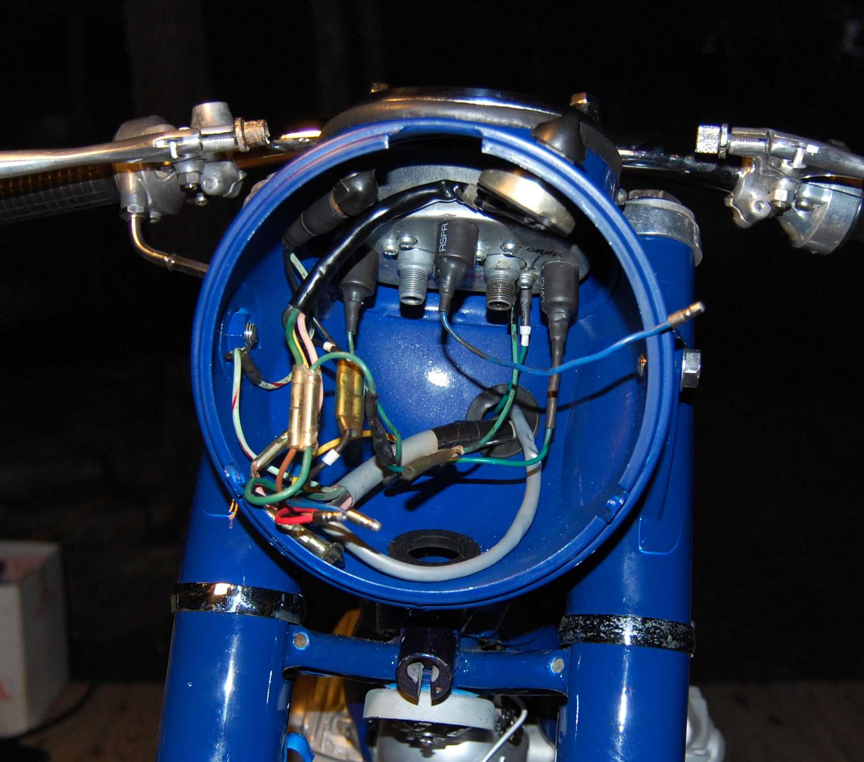

power goes to neutral light from black wire with white collar, then to switch on light green with red stripe. Other wire from neutral switch, inside right case, goes to ground to complete circuit. good luck...
If you look close you can see the boot...
