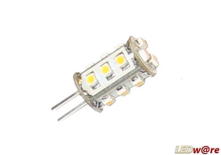

It took me a while to decide to interfere in this thread, because designing LED lamps is part of my daily job as a machine vision system engineer. On the other hand, one could conceive my interference as not appropriate or helpful, as I look at it from a different perspective. Please say what you think, as I don't want a harmful discussion. I had a few of these optics you show us on my test bench (at work), and they were acting poor. A huge transmission loss, lot's of undefined straylight etc, no defined bundle etc. If you want to use your original reflector, you have to analyze how the combination bulb - reflector is working. The bulb can be seen as a point source, and is placed precisely in a certain point in the reflector geometry. Led's on the other hand, and certainly High power led are not really point sources, because the energies per square millimeter is (for now) lower than a modern lamp filament. When you look at car LED headlights in detail, you can clearly see that the optics (lenses and reflectors) are way different then a standard lamp. A bulb has a radiation pattern of almost 360 degrees, horizontal and vertical, and uses the reflector geometry for the beam shaping. Most high power led's are having an radiation pattern of almost 180 degrees, horizontally and vertically. If you want a beam like a bulb, you need to use the reflector as a beam shaper, thus make a led device which also has a radiation pattern of 360 degree's around, and these led's should be placed in the same point in the reflector. You can make them yourself, but I like to look first at the markets, and found a view interesting forms. For experimenting only, before designing and making one, I would buy a cheap standard G4 LED lamp, easy to fit in the original reflector (see picture). If the geometry is right, I would change over to designing a lamp, based on the geometry of the G4 lamp. I would use a copper rod (six or eight sided for cooling, as a mounting base for six or eight High power, being Cree, Luxuon, or other brands, Jensen assembly of Japanese motorcycles requires great peace of mind (Pirsig)

Jensen, I don't want to use the stock reflector for the very reasons you've been sharing. That's why I looked into using the Luxeon lens. Do you think it'll work?
