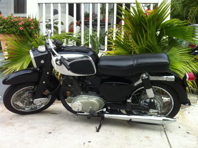

By the way, that's a very clean looking Dream. I could not figure out why it looked so "solid" and then realized it is the blacked out headers. Makes a noticeable difference.
