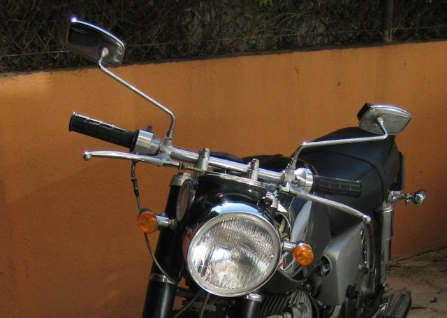

My CB has an OEM Honda harness but was, apparently, supplied to the previous owner as a spare part; it contains the correct wiring (á la Canadian-market CP/German-market CB) with the black wire from the ignition switch to the flasher relay location, the grey from the relay to the headlamp bucket and orange & light blue wires -- with double 3.5mm female connectors -- from the bucket to the taillight connections' location just before entering the rear fender. The harness has no year tag.
Oddly enough, the PO fitted the winkers but ran his own wiring (outside the harness and taped to it), so perhaps he didn't have the savvy to look into the (Euro)CA wiring diagram! My first little project was to refit the winkers as close to the method that the factory would have used, using the proper incorporated wiring. The fronts were previously clamped onto the handlebar using unpainted mild steel brackets......oh dear, oh dear, oh dear! It took me just an hour to make it all nice and rip out the taped-on wires! Pics of fronts before and after:

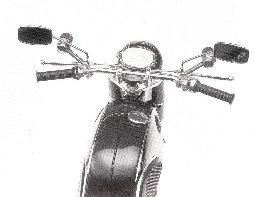

This is what I mean, this picture is from an old motorcycle magazine.
After the winter I will put winkers on my bike and picture them, the bike is repainted now.
