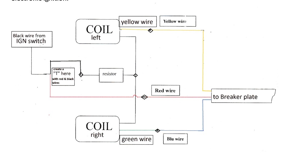

I have a short video on YouTube of how to install the TYTRONIC ignition kit. The original instructions are impossible to follow so I made a set of instructions that might help you and a wiring diagram.
https://youtu.be/yKPwMUnbRU8

Dave, you Rock, man! :)
I will try this soonest and let you know how it goes; thanks!
