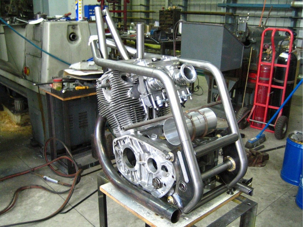

Post by LOUD MOUSE » Tue Jan 06, 2009 8:53 pm
Tis a little back in the discussion as to engine mods and frame work however here ya can see a small view of how Jerry K. in AUSTRALIA starts a real and competitive GP racer.
I'm told to look for a couple of articles about this and more of this sort of engineering with the his bikes with pics.
Thanks for sharing J. .....................lm

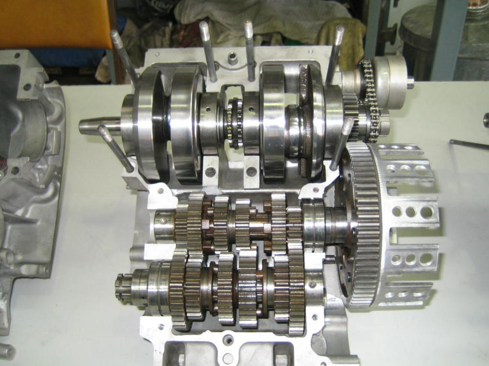

Post by LOUD MOUSE » Tue Jan 06, 2009 10:51 pm
This is a rare pic of a 6 speed trans installed (with many mods to all case demotions) of the HONDA early 250/305 HONDA engine cases which as ya can see isn't a "Just put it in There" application. Thanks again J. ................emo

Let me take in these 2 picts for a few days and I'll get back to ya. LoL

Wow LM, those are some hot photos
looks like maybe a little material taken off the crank?

I agree with the last post, it is the making a bike go as fast a possible through whatever means required that interests me. I have just completed a 350K4 racer (if they are ever really completed!) - the one thing I have learned is you may as well just buy a set of engine cases with a gearbox (to get you started!) for a race project - every other engine component will be removed/replaced/modified/destroyed in some way - the purists would be horrified, but the "gods of speed" love it.
But hey, thats what its all about!
The gearbox looks very close to the K4 five speed, including the clutch. But then again, most period Honda boxes look the very similar.
