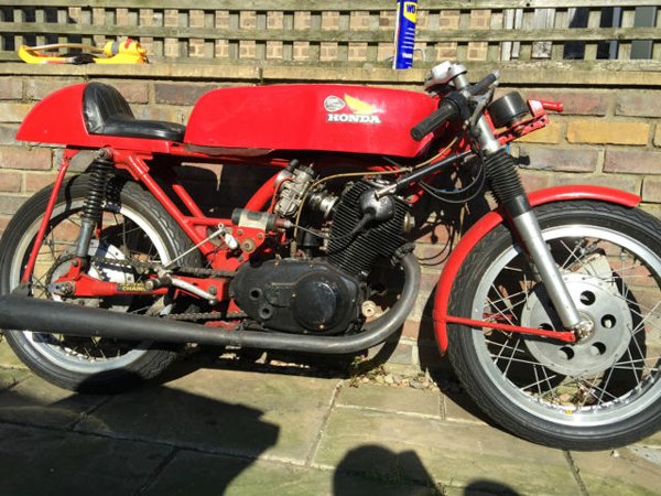

Normally the engine breather just vents to a catch tank somewhere. I think it is illegal for race bikes to vent to atmosphere so that's just a way of keeping things tidy and keeping any oil vapour from the rear tire.
Also if it results in a slight vacuum in the crankcase it will reduce oil leaks and reduce drag on the crank. As the bike wears and produces more piston blow-by it could affect the carburation adversely....

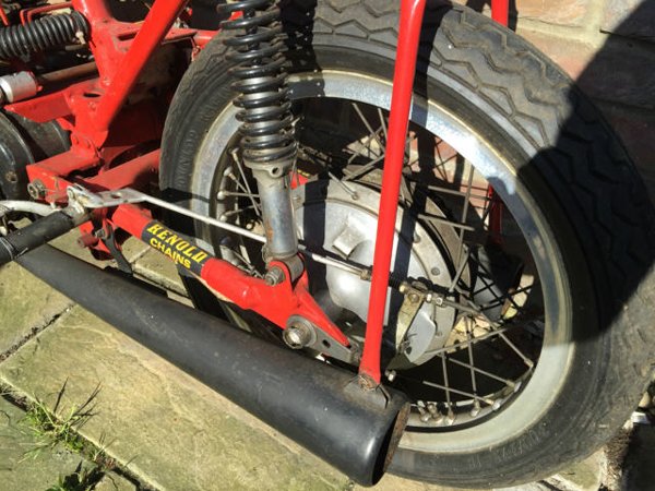

Nice gear shift and the swing arm looks pretty special, too. It would be interestesting to research the history of the bike and JRB. I'll ask around..
Has the bike got any oil lines running from crankcase to head? That's often a tell-tale of the 500 motors.

Here is some pics of the venting and gear change.
Thanks, Dave.

No I cant see any oil lines to be fair.
A couple more pics with out the fairing on.

It looks like a lot of thought and work has gone into building that bike. It will be interesting to find if that translated into results. Althought the tires must be pretty old and probably unsafe to use, don't throw them away. They would look good on a period race-bike exhibit.
If you are going to strip the engine I would be really interested to see what's inside.
Good luck with the project.

I think your right there. I have been taking a full set of pics of her. JBR Honda are still around and i have sent them some pics in the hope someone may have some info. Fingers Crossed!!
I will post more pics as I go along with the rebuild and keep you posted.
Yes the tyres are period....The rear has some age cracking to it...wouldn't want to take any chances with either to be honest. As you say they will go in to my stock of bits and bobs..: )
