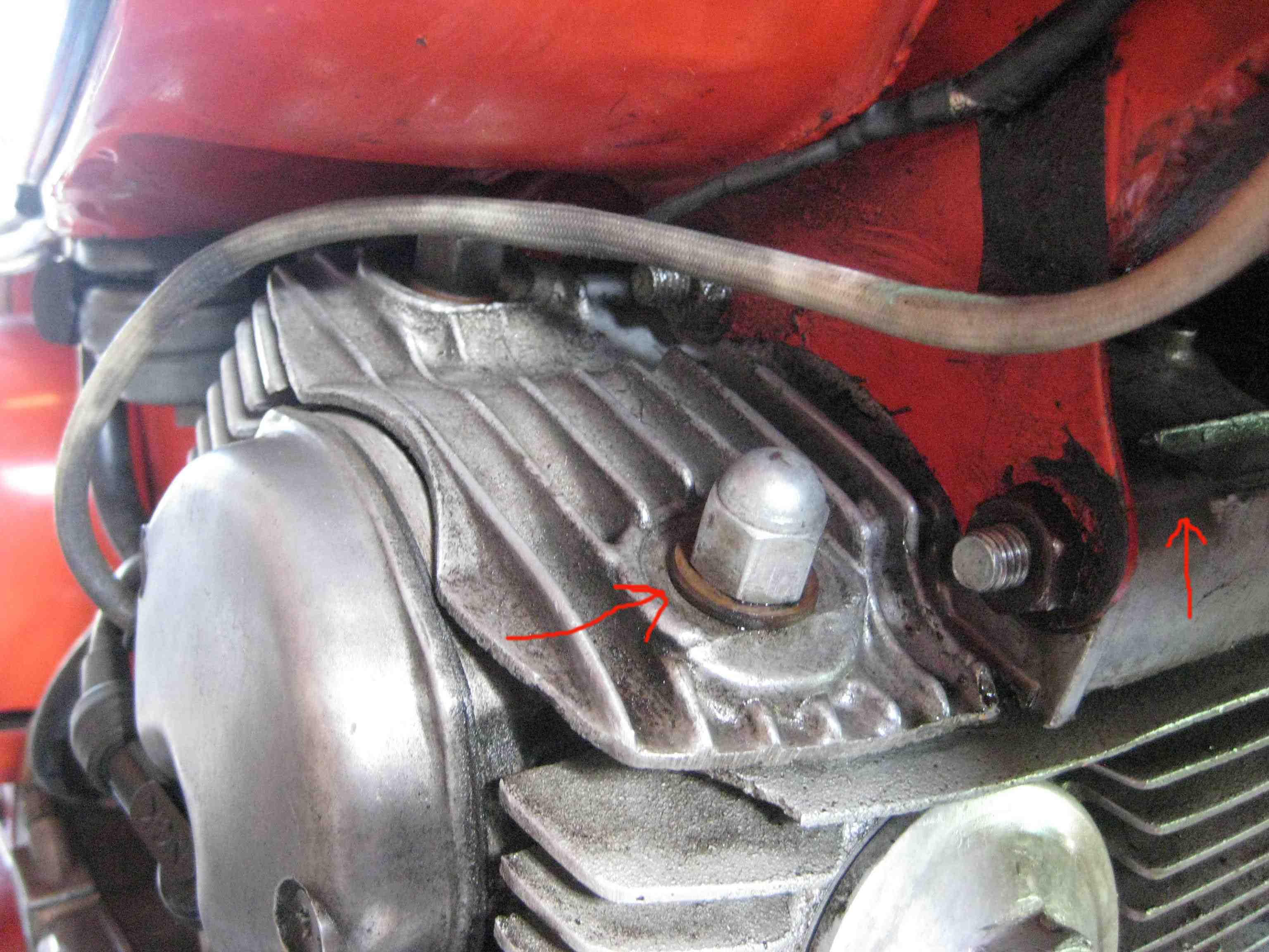

Post by mchech » Tue Sep 07, 2010 10:35 am
Hey, Teazer.
Sorry for the delay. Long Labor Day weekend.
I've attached a shot of where the leaks are coming from. The red arrows indicate specifically where the oil's coming from. Actually, they're also seeping out of the cylinder head gasket now, too. I took the bike in this morning to have it checked out.

Post by houseowax » Tue Sep 07, 2010 10:55 am
Mine did this in exactly the same place. Oil would then gather on the exhaust collar and run down the header causing quite a bit of smoke. In no time at all I blew a head gasket. When I went to disassemble the engine I found that the PO never torqued down the head nuts- they were just slightly past finger tight!

Post by mchech » Tue Sep 07, 2010 11:00 am
That's a likely suspect, House. Lots of oil hitting the collars and pipes. The guy who I work with on it is really quite good. Might've been an oversight.

Post by mchech » Sat Sep 11, 2010 4:08 pm
Hey, all. An update...
Head gasket was ripped and had shifted. Just gotta re-weld the right pipe to the frame and we'll be fine. Appreciate all of you chiming in. Thanks.
