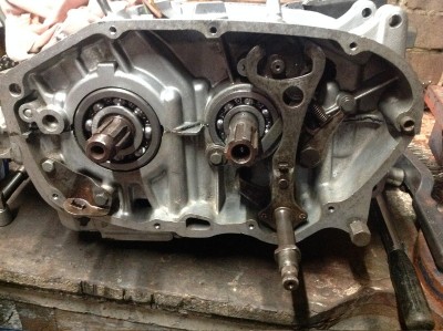

Post by Geoff Hastings » Fri Jun 07, 2024 8:11 am
I could only find this one photo of the selector on my C77, it’s probably not a lot of help.
