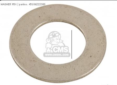

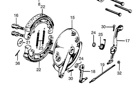

Just a shot in the dark.
Washer Pin 2.JPG (32.13 KiB) Viewed 4078 times

Post by Geeky160 » Sat May 20, 2017 5:49 pm
Geeky160 wrote:Just a shot in the dark.
Washer Pin.JPG (24.08 KiB) Viewed 4076 times

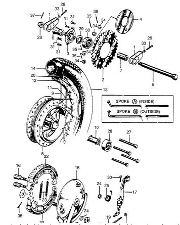

Post by Geeky160 » Sat May 20, 2017 5:55 pm
Or...
Rear CL72.JPG (44.37 KiB) Viewed 4074 times

Thanks for the reply. That looks about like what I'm thinking would be there, but for the 65 I haven't seen any reference to it. It looks like your diagram is for a later model with the double leading shoe brakes. The 65 has single leading shoe so there may be a difference. I will sort through my parts again and see if I run across anything. With the pieces assembled it appears the only point of contact without a shim is actually the inner race of the bearing, but I'm still skeptical though.

The inner race of the bearing does not rotate so it is perfectly feasible for the brake plate to clamp up against the bearing inner race. The bearing is backed up by the distance between the two wheel bearings.
See here...
https://www.cmsnl.com/honda-cl72-scramb ... ml#results
Posts: 5678
Post by G-Man » Sun May 21, 2017 10:04 am
I just pulled this one apart for you. The raised area at the centre of the brake plate rests only on the inner race of the bearing.
