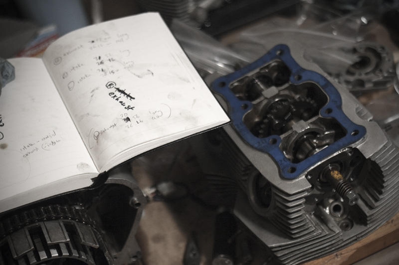

I spoke with Teazer on the phone who was a real pleasure and very patient with me. Since there was nothing obvious upon disassembly, I pulled the rockers and measured the cam lobes to make sure everything was in spec. Everything measured up well there and the rockers looked fine.
One thing I did notice was some lateral play in the advance weights on the cam. They both have about 2-2.5mm of side to side play. I don't know if this is normal or not, maybe someone can say for sure.
I'll be moving onto the examining the valves this weekend. Looking for anything, even the slightest thing that could be causing the engine noise or a small oil leak on the left side.

A late update to the "clack- clack.
I have most of the cam parts here and what I find is:
The neoprene on the advance weights is compressed so far that the weights lay on the center casting of the cam insertion area and with that as the engine runs and the as weights move out/in they TAP on the center casting.
The valve rocker arms are good all the way as are the rocker arm pins.
The cam chain tensioner even though it is the early (set bolt installed from the left) and has the smaller neoprene wheel is good.
Rotor is a C72 rather than a CB72 but has timing marks (HONDA made) for timing the Left Side points and setting the valve clearance.
It's the one which charges at a higher rate than the C72 (L), CB72 (L). .............lm
