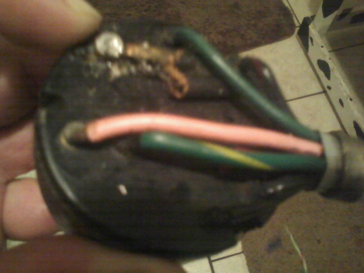

Can anyone tell me what wire.....if any.........goes to the terminal in this pic that i previously soldered a wire to? I had to break wire off........................so, the terminal i am speaking of is the one with solder splatter on it. thanks

linemup, if you look on the back of the switch, there should be cast into the plastic coded letters for each wire. You may have to get some of that solder removed to see which 2 letters are there or go through the process of elimination by comparing what letters you can read to the wiring diagram to determine where the wire goes, which you will find attached with the link at the end of this post. Make sense, no? I'm assuming this is for a CA77, if not just locate a wiring diagram for your model and it'll work out for you.
