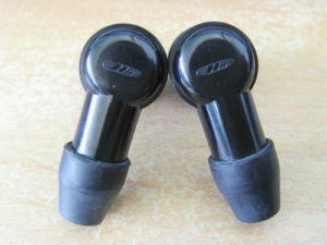

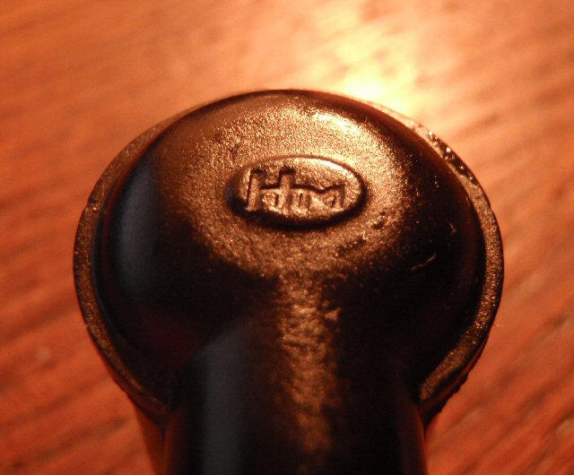

I really don't know Jensen. Here's a photo.

Post by jensen » Fri Aug 20, 2010 4:01 pm
Hi,

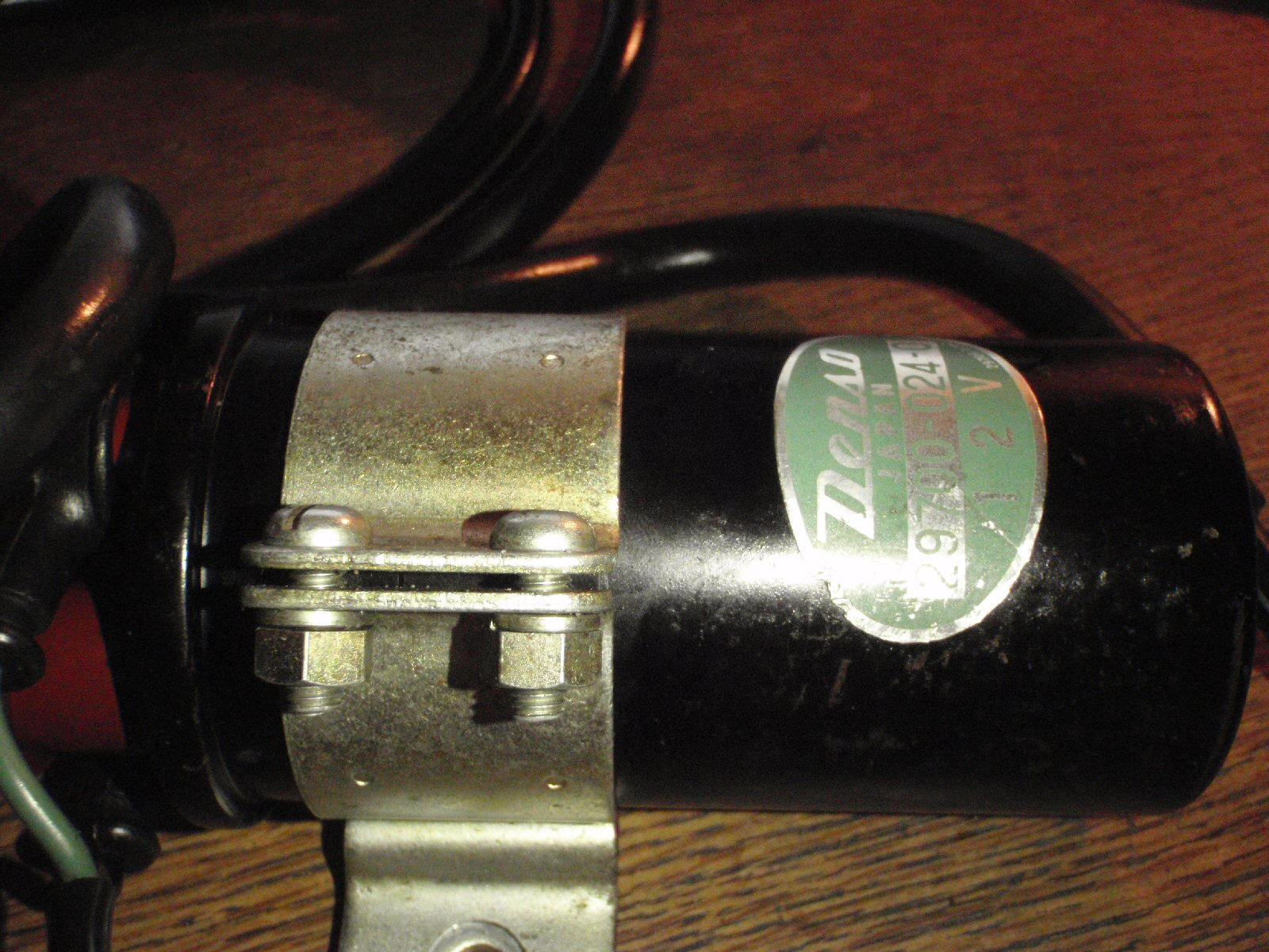

I have a few old ones lying around (not nos but used), and these are original. I will look for them tomorrow and see how these are attached to the cable, The pictures included are made by me a few months ago, please compare them with your own. These are attached to a early type coil for a type dream. I compared these plugs with the ebay caps, and I'm afraid that yours are a (good) copy. the original caps are made from different plastic (Bakelite) very fragile, and the logo is above the material of the cap. These caps also are on C71's and C76, and 1960 / 1961 CB72's
Jensen

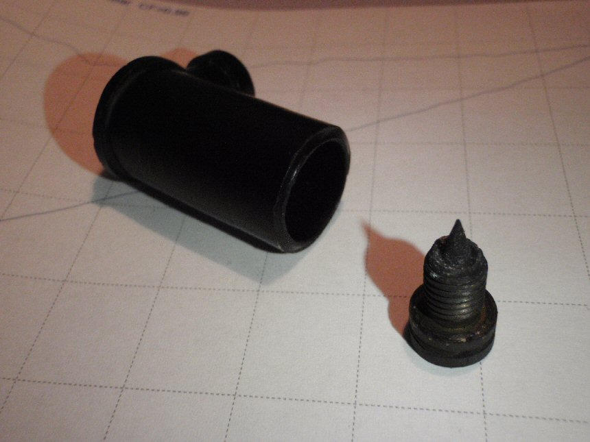

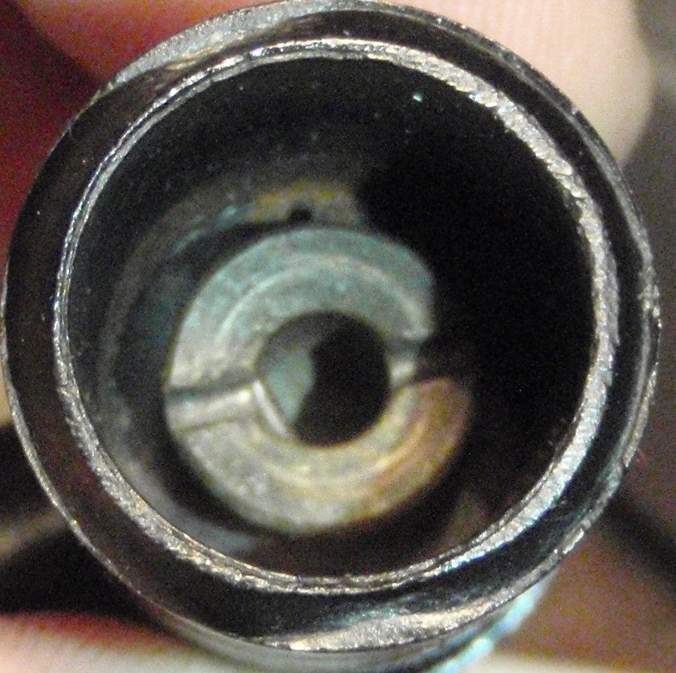

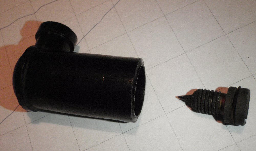

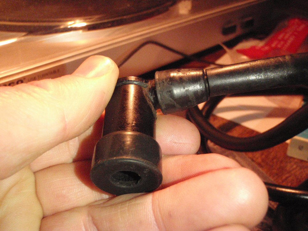

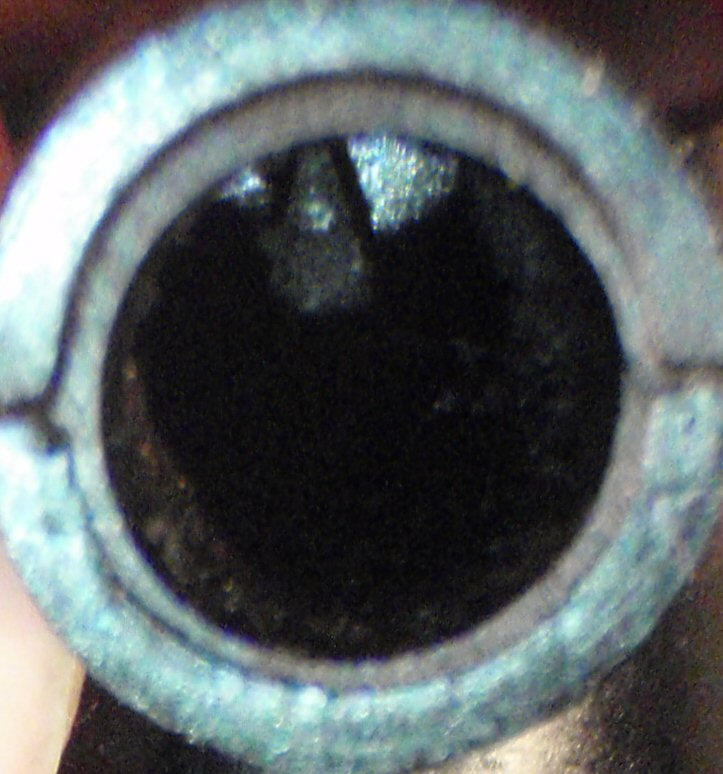

Post by jensen » Sun Aug 22, 2010 9:57 am
Hi,
There are pins in mine too, those pins secure the cable very good. The original caps have a pin which you screw into the cable with an angle of 90 degree's (via the part witch is on the plug's).
This way of securing works very good, it secures the cable, and puncture the cable n the right place.
Never try to turn them from the cable, the pin will bend and cannot be removed again, also the thread inside the cap is very, very delicate (plastic, hot, dry).

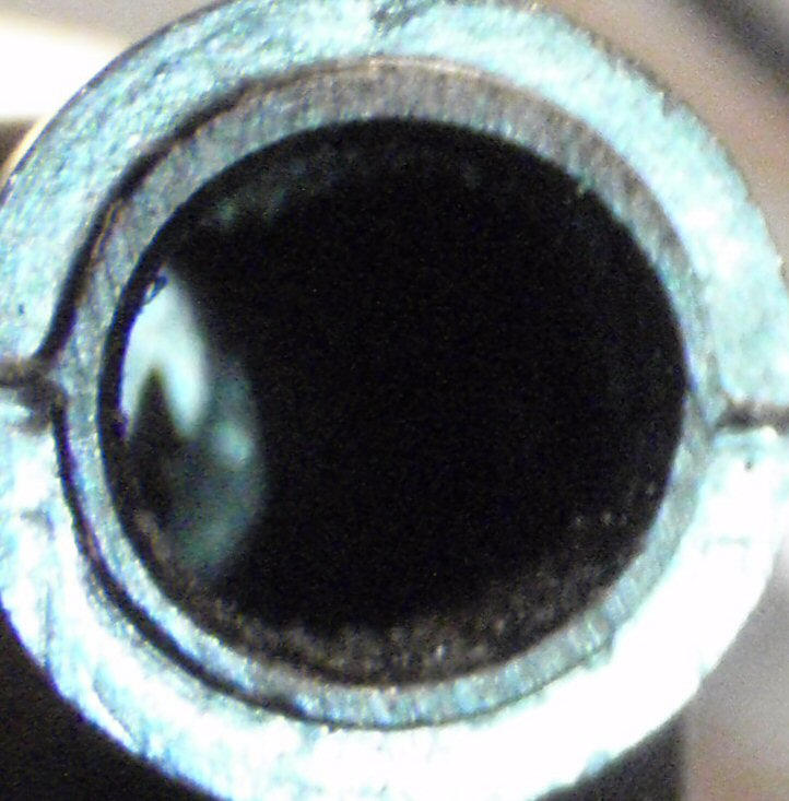

These plugs belong only to the very early CB72's, 1960 and 1961. I have never seen them on CB77's, and I guess that these were not used on them, but I can be wrong here, because in 1962 (end of year) Honda introduced other caps. The first CB77 was introduced in 1961 (at least in the US). In Europe we had to wait a little longer, probably until 1965 / 1966. But the CB450 K0 came in 1965, so the CB77's didn't sell here because of that.
Jensen
