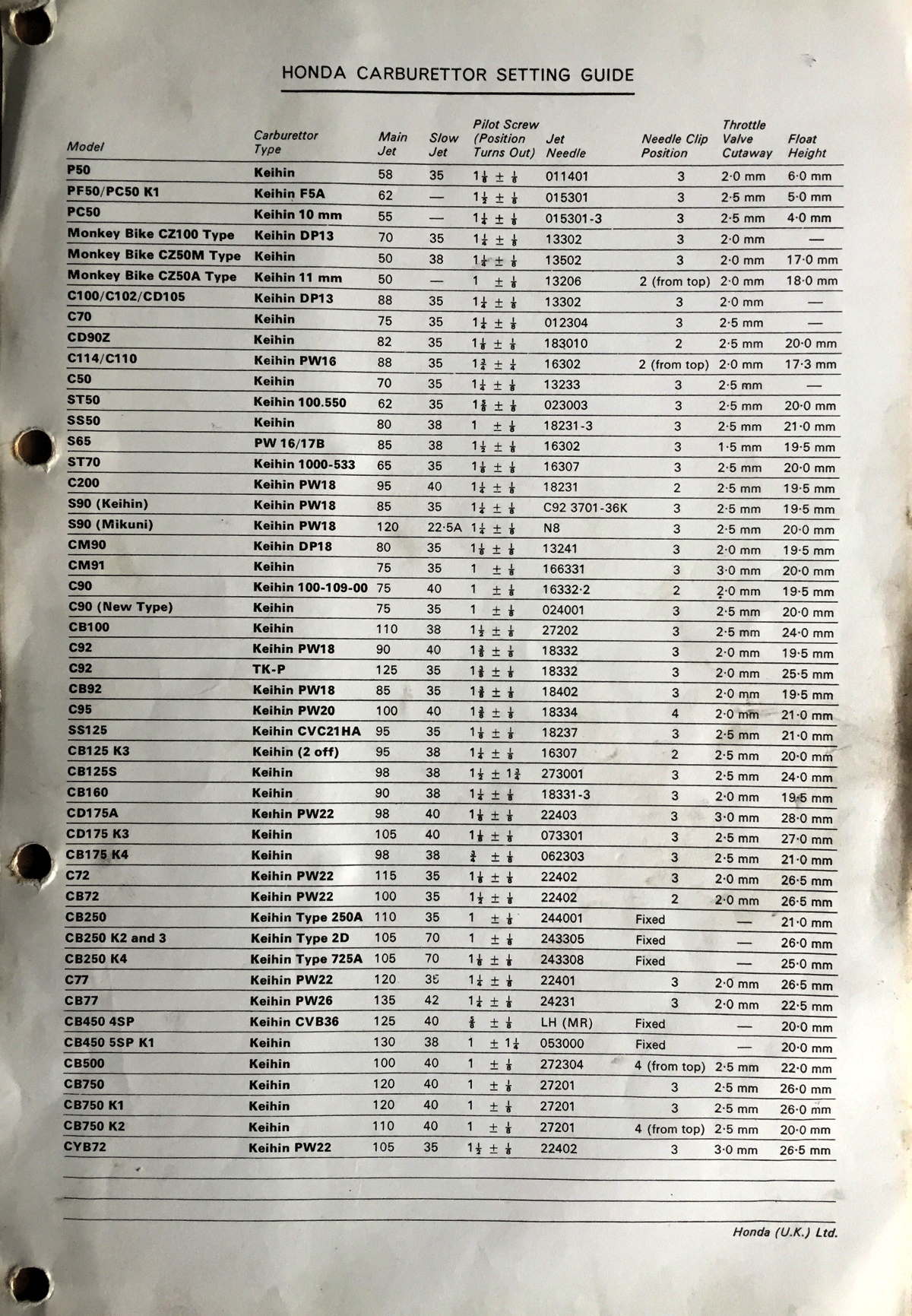

What are the stock jet size on a pw22 carb?
Posts: 5681
Post by G-Man » Mon Jan 25, 2016 3:23 am
Here you go....

Post by bluejean » Mon Jan 25, 2016 4:27 am
Thanks this is a big help
