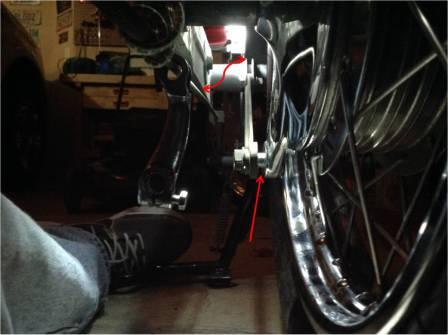

When I got back to my '61 Dream project today, I did so with an entire work week to ponder the differences that cause the offset between the surface of the brake hub tab and the tab on the swingarm. The difference I found today is that the distance from the inside surface of the swingarm, to the closest surface of the tab is 2" on the '61 (shown), and it is 2-1/8" on the '65. (see curvy red arrow) You can see the offset difference on the bolt (see straight red arrow). If I use the 61 swingarm, I'll have to put some washers on there to take up the offset, or use the '65 swingarm.
There doesn't seem to be any difference in the height of the brake hubs (measuring inboard to outboard) between the two model years, although they do look different in other ways.
I'm not sure if this helps at all, but thought I would provide some observations on my particular bike build.

We'll after all that explanation with circles and arrows and an explanation about what it was (to paraphrase Arlo Guthrie in Alice's Restaurant) I discovered that I had attached the bar both upside down and backwards. The bar has a slight offset to it and once properly oriented, eliminated the gap and need for washers on the brake hub end.
