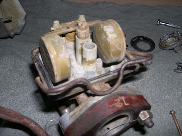

the diagram can be found here : http://www.cmsnl.com/honda-c72_model743 ... t/E12.html the clip should be towards the front, with the 'u-bend' pointing towards the front. i'd guess if you're having this much difficulty you have it reversed ( u-bend to the rear). the clip should slide over the bowl with finger pressure, shouldn't need to pry it with a screwdriver. including a pic of the bottom of my ca77 carb. i don't believe it's identical, but i think the clip is located/turned in the same manner as yours. post us some pics please ! -smile-

Thanks guys. I answered the first question myself when I took the Carby off today and had a decent look. The low speed jet was clogged and I cleared it out with a single strand from a wire brush. I then gave the bowl and body a clean with a toothbrush and some wire wool. Overall there wasn't much in it and it all seems to be in pretty good order. Have reassembled it and mounted it back on the bike with the air screw in the (hopefully) right position and now just wating for a nine month old to wake up so I don't wake him up when I kick the bike over.
