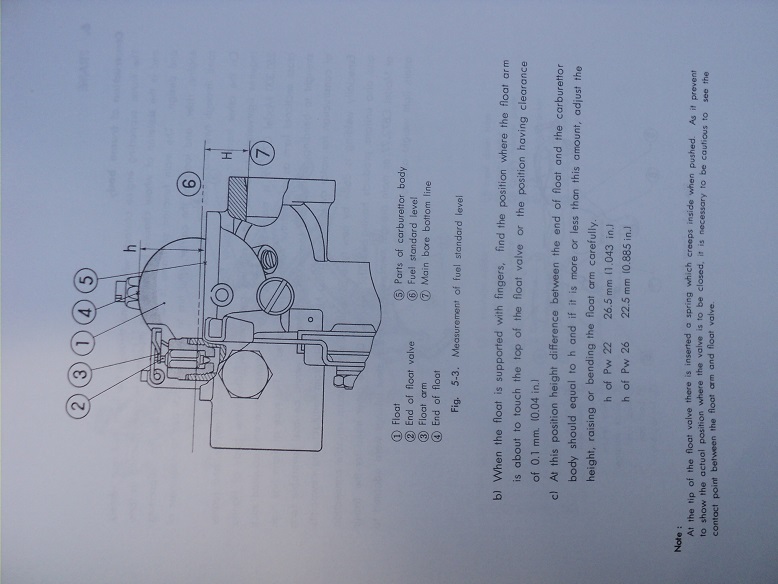

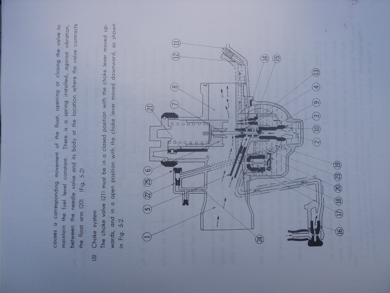

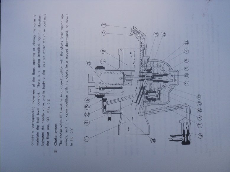

This is the manual I have from E-Bay.
Tried pics of the carb description pages, hope they will be readable.
(Watch out for any differences between PW22 and PW26.)

Post by R100 » Wed Sep 02, 2015 11:09 am
P.S. The shop manual on Bill Silvers CD appears to be the same.

Post by DianneB » Wed Sep 02, 2015 12:00 pm
Thanks man, that helps!
