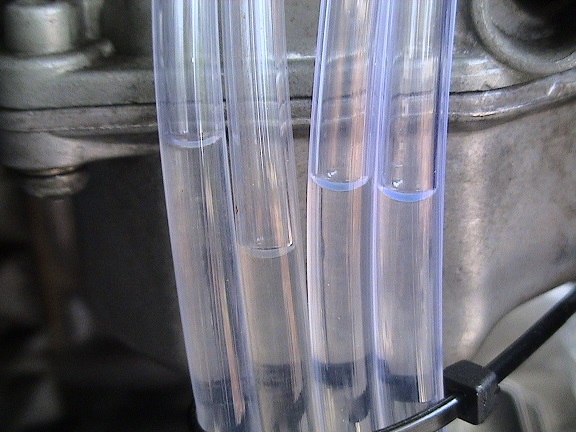

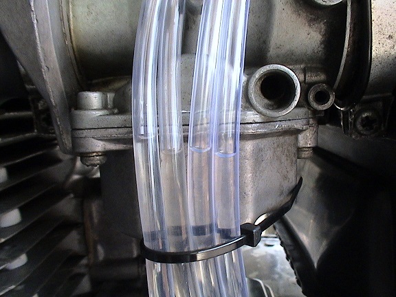

+1 on the hysteresis.
After installing clear tubes on my 750, I found there was a significant difference in the fuel levels after sitting with engine off vs running and idling.........so, just because the tubes show a given level with engine off, doesn't mean it holds true while operating.......which I ASSUME is the condition which the level is designed for?
Add in the level changing due to vibration, bumps and curves in the road, accel and decel, the level may look more like a washing machine than a lake inside the bowl?
level after running1.jpg (108.3 KiB) Viewed 1811 times
