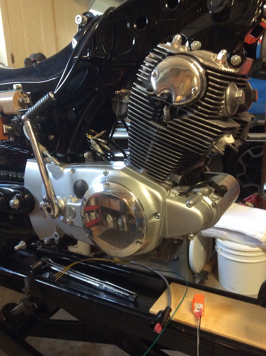

Small progress today. The clutch adjuster bolt I needed arrived this afternoon, so I was able to finish the right side up. I still need that small plug for the kick start knuckle. Not sure if I like the polished covers. I might tone them down later with a fine Scotchbrite pad.
I also neatened up some wiring. I'll make the final electrical connections to the regulator/rectifier tomorrow and mount the winker flasher.

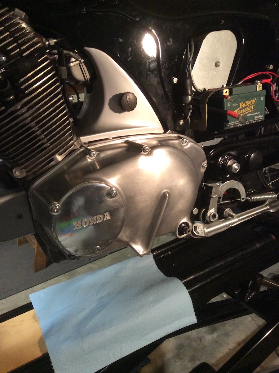

Well, the cover is certainly weeping. It's better than before, but a leak is a leak. I drained the oil and removed it. I decided to try the new cover, so I installed a new shift shaft seal and the oil filter cover and, using the same gasket, installed it. Lacking the longer screw for the far left mounting hole on the underside I found a cap screw of the proper length to use for now. after adding oil, it seems okay, but I'll check it tomorrow morning. I'm not overly hopeful. I've had enough for today.
- The new unpainted cover in place to check for leaks.
- NewCoverTrial.jpg (367.78 KiB) Viewed 1883 times

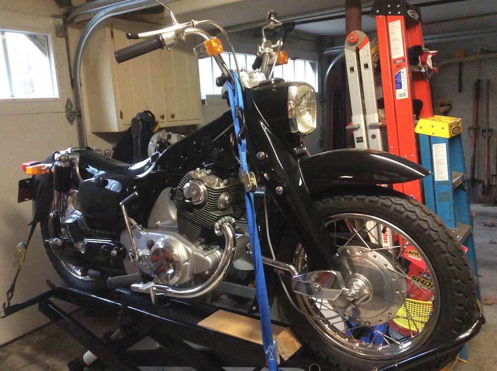

- 8March17.jpg (240.02 KiB) Viewed 1906 times
