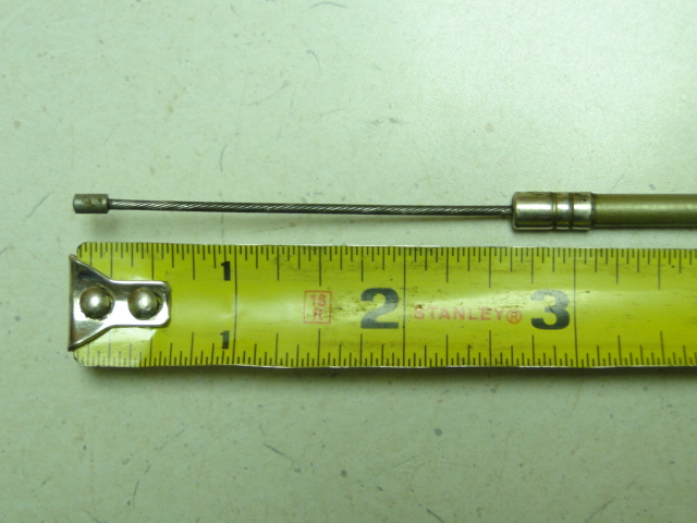

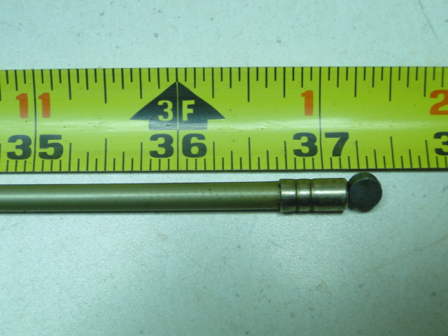

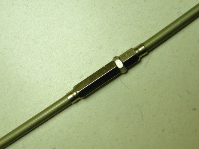

Bob - Unless there's an early/late difference, I've only ever seen the internal throttle cables routed behind the headlight bucket, around the steering neck, and into the frame on the LEFT side with the harness or one hole behind it. I attached some measurements of an OEM cable for you to compare yours to. I have a few more OEM head gaskets than I really need too...
-48
-48

Thanks, 48.
I haven't taken the cable out yet, but when I do tomorrow, your photos will be a great help.
* If it's the same length as your OEM, I'll install it through the LEFT side and see if that makes the difference.
* If it's not a standard length, I'll debate whether to a) ask Retrobikes whatsupwidat? and try for an exchange, b) try to modify mine, or c) order OEM from Nick or wherever else I can find one.
In fiddling with it on the bike today, I can see nowhere to make up the ~1 to 1.5 cm I seem to need to make it work right, and have some adjustability.
